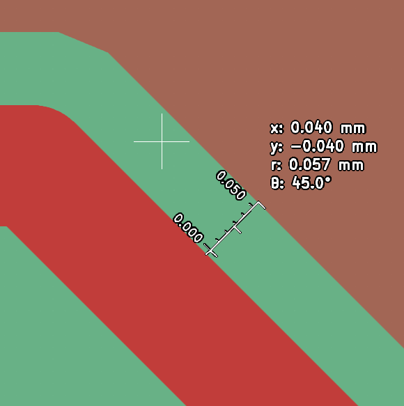

Hi everyone,
I’m encountering an issue with copper clearance in KiCad. I’ve set the default clearance to 0.12 mm in the design rules. However, when I create a copper zone (GND) on the front layer, the clearance between the copper trace and the zone is only 0.06 mm.
I’m trying to understand why this is happening. Is there a setting or rule that might be overriding the default clearance? How can I ensure that the copper zone respects the 0.12 mm clearance from traces?
Any insights or suggestions to resolve this would be greatly appreciated!
Thanks in advance.
Clearance can be overruled with custom rules. Did you create custom rules?
Check Design Rules > Constraints also.
I created a custom rule to enforce a 0.07 mm trace-to-copper clearance for specific footprints, notably BGA fan-out. However, KiCad seems to apply this 0.07 mm clearance globally instead of just to those footprints—could my footprint-specific rule be overriding the default clearance? In DRC, traces under the default 0.12 mm clearance correctly trigger errors, but ground-plane violations don’t report any errors, even though the inspection tool measures only a 0.06 mm gap. Is this a bug, or do I need to update KiCad?
