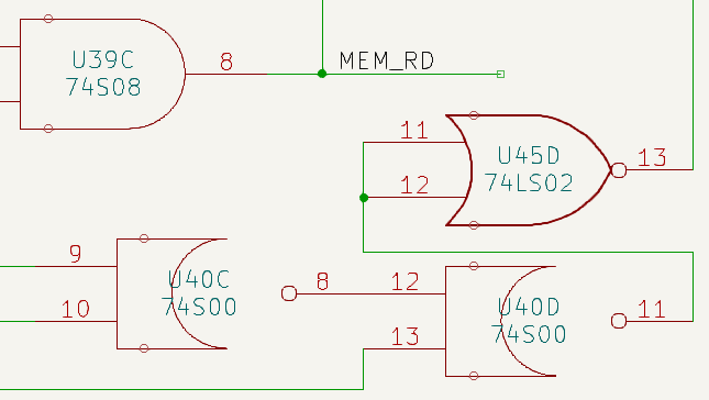

On first sight it all looks quite plausible. Only the 74ls00 gates have an arc pointing the wrong way:

  7. Error: Input pin not driven by any Output pins**. There are 3 of these for U22, and one of this for U40. All four of these are because of a fault in the U39 symbol. The output pins of this 74S08 gate are set to open collector, while this gate does have totem-pole outputs.
