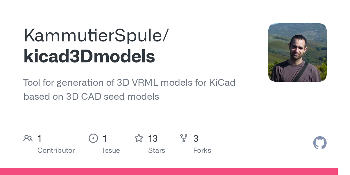

I just couldn’t miss your idea and this opportunity and I just created a script using my only know script language C/C++ to generate this!
I created an open source project (GPL3) and generated 1000 1/4w axial resistors wrl files! … more to come latter… project is here:
The model files are distributed under a modified MIT license, but if you need any special license just for you I can think about it!
The Film Resistors zip file is here:
https://github.com/KammutierSpule/kicad3Dmodels/blob/master/generated/Resistors/kicad3Dmodels-Film_Carbon-v0.1.0.zip?raw=true
The zip file is 898Kb and contains already a .png screenshot of 347Kb.
Each wrl file resistor is just 550 bytes length!
The wrl files are based on a recursive include directive of VRML format that will include the seed models and adapt as need.
I created the original models (my first creation) using FreeCAD (file included) the only thing was that the STEP file generated by FreeCAD was not OK :confused:
Then the WRL files were generated with StepUp by @maui
I appreciate if someone with knowledge in this area with FreeCAD can have a look and see if you can generate a proper STEP file because mine was broken. (May I will need to make some adjusts in the design? look for suggestions… )
Also, I appreciate if anyone could review my design (sizes) and resistor values if they are OK.
There are some things to know about this WRL files:
  • It only work on the (upcoming) KiCad 5 (with the new 3DViewer developed by me @kammutierspule with the cache and WRL parser developed by @cbernardo)
  • Every time you use a model, it will be cached by the cache mechanism of the 3DViewer. The cache size per model is 888Kbytes (Maybe @cbernardo one of this days will implement a faster compress system for the cached files :open_mouth: :wink: ) . I think that will be OK if you just use a subset of values on a real case life scenario…

Hi Mario,
very nice rendering and models! :smiley:
I fixed at least the main body of your resistor (I used a closed sketch to revolve… an open sketch is creating a shell not a filled solid)
resistor.FCStd (17.4 KB)
resistor.step (33.7 KB)
Edit:
release 2 full fixed (with the sketch for sweeping fully constrained) :smiley:
resistor-ok.FCStd (24.8 KB)
resistor2.step (37.1 KB)
