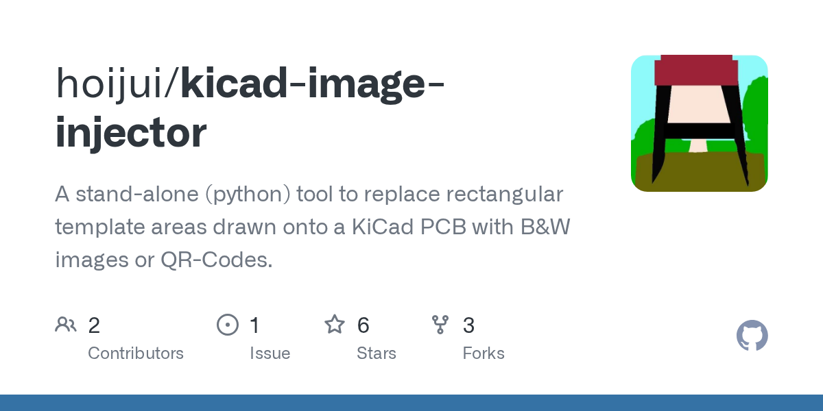

I continued working on this, and it is mostly working, but missing one crucial part.
The code:
What works:
When drawing a polygon or zone in rectangular, axis-aligned shape (4 points exactly) ontho the PCB on a slik or copper layer in PCBnew, the script loads that PCB from file, replaces the rectangles with a pre-generated “qr.png” image.The nsaves that to a new *.kicad_pcb file.

done.
I would now consider it in beta state -> feel free to try it!
