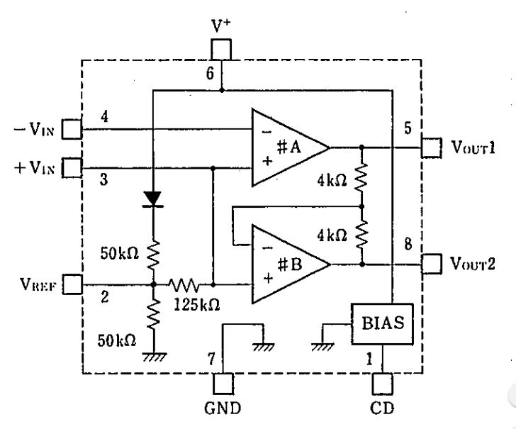

What if the internal connections of a package were not accessible on external pins?
Could you give any example?
Here you go (especially in the audio IC environment, there are dozens of these integrated circuits); I suppose that in these cases you can only use “dummy” circuits which only handle the externally available pins, can’t you?
Well. I see neither the reason nor possibility to split this kind of circuit to the three separate parts. They are not independent.

I won’t argue what is the better example and what not.
Both examples are alike having internal connections with no external pins available. So I think the best workaround is to just look at the outside of the pins and create the adequate symbol/footprint.
On the overall schematics side one should then reference to the internal circuit of the component(s). Imho a screenshot of the datasheet circuit and attached as picture to the schematics will do.
