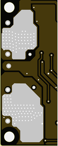

I’m learning KiCad and board design. I know at the frequencies I am working with, I probably can make a lot of mistakes, but I want to learn good procedure. This circuit takes an 8kHz square wave input (18V peak max), rectifies it (pins coming in from the left), regulates it (the big area in the middle for a AMS117 5V regulator), charges a capacitor for a “keep-alive” (the next 2 pins that are vertical), and powers a few LEDs or similar up to 1A. Bottom layer is a ground pour, top layer is a Vdd pour. The grounds from the bridge rectifier, 5V regulator and 1000uF capacitor need to be via’d to the ground side. What is the right way to connect these? Can a create a polygon of some kind connecting the close-by grounds and put a via or 2 or inside them? Can I do it like I have with vias and traces to connect things together? I have made only to top, Vdd layer in red visible for clarity. Thank you.
EDIT: Great stuff! This is a very simple circuit. Someone else’s. I wanted to model it and design the PCB for it. All it does is take a bi-polar digital signal from a model train track, rectify it, regulate it charge a capacitor, and run a few leds for lighting in the train. Dirty wheels, dirty track, etc. mean for dropouts. So this is just so that the capacitor can power the LEDs for fractions of a second when these dropouts occur. I also questioned the design, because I don’t think it accounts for the voltage that appears at the bridge. First one rail is 12-18v with respect to the other, then it switches. 8kHz pulsed with 58us and 116us pulses. The bridge would see that as up to 18-1.2 = 16.8V. So 16.8 -5V is 11.8V wasted as heat. Here is the schematic:
Yes, but it can make soldering hard, since polygons can remove a lot of heat.
Yes. But i would check the trace width and current. Why are there 2 tracks and 2 vias at each location? How does the PCB look like on the other layers?
A 0.4mm is more than enough for 2A, you don’t need more than 1 via for your current expectation.
It is hard to see what you really want, maybe you can upload the schematic?

  4. I like to use multiple vias, especially when current is involved. I tend to be conservative. I would like to use 3-4 vias for 2 Amps of current.

Yes indeed. The part shown on the PCB is just a linear voltage regulator. Apparently there is some bridge rectifier, but it’s not very clear what it is on the PCB. Maybe the footprint on the left with pad 4 as GND? If that is so, then it’s missing a buffer capacitor. Using a 1000uF buffer capacitor after the AMS1117 is also… unusual. I think a 22uF capacitor is recommended for the AMS1117. The 1000uF would do more useful work if you put it between the bridge rectifier and the voltage regulator. You also have to verify the ripple current of your electrolytic capacitor.
Using multiple via’s is just fine. It increases current handling, and also reduces track inductance, and therefore makes the connection capable of handling higher frequencies. But both your AMS1117 and 1000uF capacitor are not capable of “high frequency stuff”.
Max current for an AMS1117 usually is 800mA. (There are many manufacturers of this chip). It may also get quite hot at higher currents (and higher voltage over the regulator) Removing the thermal via from the big pad and directly connecting it to the big zone helps with keeping it cool.
Electrolytic capacitors do not like heat. Their lifespan decreases significantly with even small temperature rises, and electrolytic capacitors are already the most unreliably electronic parts. An electrolytic capacitor at it’s maximum rated temperature and ripple current may have a life expectancy as low as a few thousand hours. That is just a few months (Yes months, not years!)
So putting them a bit further away from heat sources is always a good precaution. According to the datasheet of the AMS1117 there can be up to 10cm between the AMS1117 and it’s output capacitor.
AMS1117 is also a quite old design (maybe 20 years?) Low-drop voltage regulators have some issues with output capacitors, especially if they are big and have low ESR. This may cause issues if you have lots of ceramic decoupling capacitors on the rest of your PCB.

There are 2 vias and 2 traces at each location because I was wondering if I needed to distribute the current and heat to the ground layer. (There are just 2 layers)

I would use a lot of vias, strip the soldermask to expose the copper plane, and not use thermal spokes around the collector tab and pin. The attached are cropped from a 2-layer layout I did. The SOT-223 transistors are required to each dissipate continuous 2W heat by using the copper planes as heatsink at 40C temperature rise on 2-Oz copper over 1.6mm FR-4 material, without using forced air flow.
Top side:
Bottom side:
All these vias are for heat conductivity.
At 1A max current in your layout, there is no need of sharing current with vias.
If you want linear regulator the better result you will get with 7805 I think. There the power pad is GND so you can have at top and at bottom GND planes and connect them under 7805 with vias to dissipate power through both planes.
