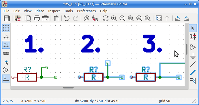

I noticed a difference, maybe there is a problem with the connection point. In KiCAD 5.1.10, placing two lines to the pin of an element looks like on the picture. In version 5.99, no junction is automatically placed. It cannot be placed manually either. Is this correct?
junction
Hi @Olo
You are correct.
I was just experimenting and found the same problem, however, if you then move or drag the component the junction automatically places.
Also, if you then delete both wires, move the element, then replace the wires, the junction is placed.
The junction is not automatically placed ONLY when the element is first placed on the page from a library.
This must be a bug.
Anyone else care to test?
EDIT: If you place a third wire onto the pin the junction appears which is understandable.

  1. Place a resistor, Draw a wire from it. Draw another wire from it. No junction dot is placed.
  2. Draw an L shaped wire, place a new resistor on it. No junction dot is placed. Attempting to place a junction results in “Junction location contains no joinable wires and/or pins.”
  3. Place a resistor, Draw a wire To it & continue. No Junction dot.
If you drag a box around it & move the resistor + wires, then a junction dot is added.
No need for a box. Just move or drag the resistor a small amount then move it back and a junction dot will appear.
If you then delete the wires and move the resistor to somewhere else then replace the wires, the junction dot will appear.
As I mentioned above, the junction dot will not appear only if the component is placed on the sheet from a library.
I thought I confirmed this, but just to be clear:
Yes, it only happens for me if a schematic symbol is placed for the first time on the schematic directly from a library.
If a schematic symbol is copied from another schematic symbol, the bug does not manifest itself.
Drawing a box & moving both schematic symbol and the wires keeps the same orientation / connection between the two, but KiCad adds the junction dot.

I created an issue on gitlab for this:
The bug is only triggered for a freshly places placed schematic symbol taken directly from a library.
It is not triggered if a schematic symbol is moved after placement, or if a copy from an existing schematic symbol is made, and therefore I also would not expect the bug to be triggered in a converted schematic.
