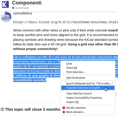

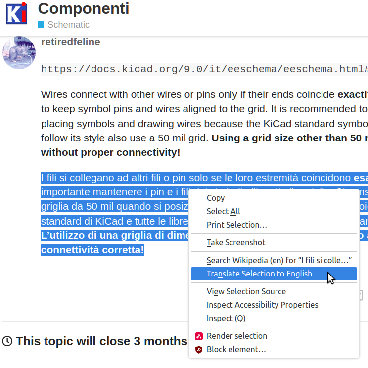

It is discouraged to use any other language then English on this forum. When you use another language, then there are very few people who can understand it, and more importantly, it also breaks the search functions on this forum. There are probably many more people searching though old forum topics to find answers, then there are people who post questions. It’s also more efficient you translate your own post, then let others translate it for you. Translating tools are ever becoming better. You can use online translators, but recently I discovered that there is even a translator built right into Firefox. Just select some text, right click and use the translate form the context menu.
