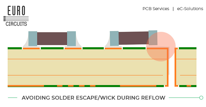

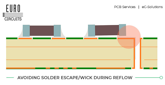

Another way is to look around for things to learn. For example Euro circuits has a few tips on PCB design:
At the link below you can find a list of PCB manufacturers. Some will have more info on “best pracices” while designing PCB’s.
https://www.eevblog.com/wiki/index.php?title=PCB_Manufacturers
There are many details spread over lots of different sources.
In a datasheet about range of MLCC’s (Multi Layer Ceramic Capacitors) I found layout rules to prevent damaging the capactors by V-scoring.
MLCC’s are brittle / fragile and V-scoring adds bending stress to a PCB at the end of production (Even after testing, because most testing is done on the panels).
