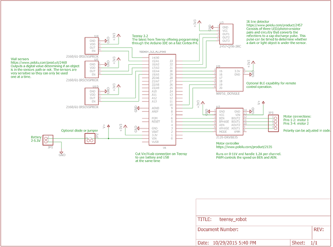

Component 'MC1' pad '30' not found in footprint '.pretty:Teensy3_2'
After adding several pins to a part, using them in the schematic, then saving the netlist, running CvPcb and saving the changes, and then reading the netlist on PcbNew with “Dry run” checked, I keep getting the error “Component ‘MC1’ pad ‘30’ not found in footprint ‘.pretty:Teensy3_2’”. If I display the footprint on PcbNew using the footprint editor, the footprint is correct with the added pins. I’m at a loss here. Can anyone help? I’m running version 4.0.2-stable.

Show us your footprint and schematic symbol.

Some pins have circles at the end, some crosses. Presumably something to do with signal type. I notice pins 26 and 30 have the same name but different termination type. Same for 1 & 31
And while you’re at it, don’t draw symbols like the real thing… sort and order the pins according to your circuitry logic (usually inputs left, outputs right) and get the power pins to the top/bottom (vsupply at top, ground at bottom).
The symbols in 99.5% of the case never resemble the real devices layout.
Also your footprint is missing the modules outline on F.Fab and the placement margin on F.CrtYd. Might also be a good idea to mark out pin #1 there.

As far as redrawing the module, all pins except for the power and ground, are input/output. What side of the module would they be?

Personally I’d probably put the Reset, DAC, RS232 and I2C ports to the right, the common I/O to the left (in some sane order) and Vsupply at the top and GND/AGND at the bottom. This makes it possible to draw schematics that kind of read from left top to right bottom and one can follow the flow of energy/information, but maybe that becomes less and less important in the digital age, who knows?
This one does some of it in the Teensy schematic symbol (decoupling real thing from symbol):
Another good example for an Arduino:
Remember that the symbol shall help you to understand/design the circuit. How it then looks like in the real world is absolutely unimportant.
