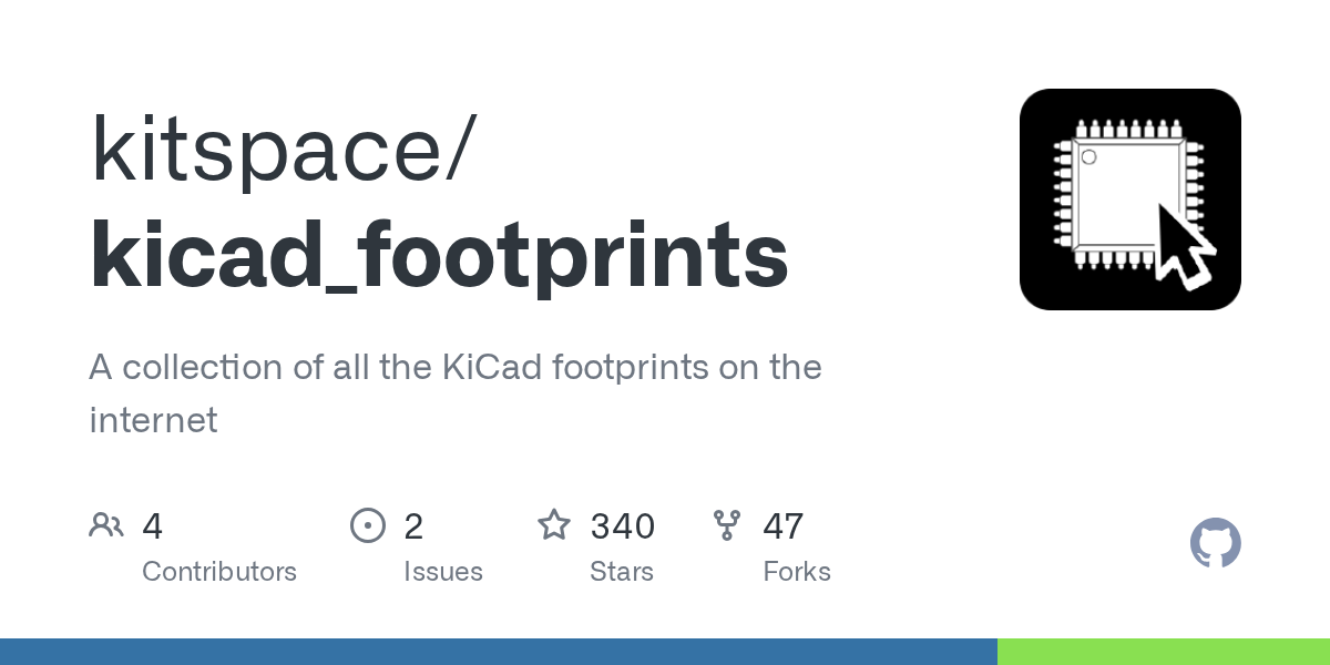

Looks neat! I have been collecting all the footprints I can find in a GitHub repo:
(Reminds me that I need to run an update on that when I am on better internet)
I also have a little script that searches GitHub through the API which works surprisingly well and you could easily do for your site (if you don’t already).

This repo is very, very useful. Cloning it and being able to search it using KiCad is great. Even includes the master KiCad footprints.
I was going to add this to my list of 3rd-party KiCad tools, but it was already in there! I really should read my own list, sometime.
Awesome script and repo! I’ll add it to the ingest sources.

Do I have your permission to index your repo?
Of course, it’s all public info, mostly from GitHub. Any scripts in the repo are do whatever/MIT licensed but it doesn’t seem like you need those.
I had some issues ingesting your repo, a number of the submodules are broken (auth required etc) and my library does not cope with that very well. I’ve attempted to pull out the interesting repos directly.

I think those issues should be fixed since I updated everything. It’s mainly when people remove their repos: if you try and git clone deleted repos over https then it asks for authentication, even though it would fail even if you gave it.
