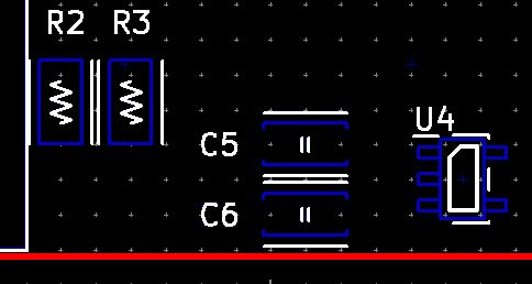

Cluttered dwgs.user and silk layer
Information on one layer shouldn’t really be repeated in the other by default… right?
For example, it would be nice if the reference was silk only, and the value drawing only. I’m sure some people may prefer it differently though. Also the default font for some components is gigantic relative to the component size, would it be possible to have a default font size embedded in the footprint? The value for instance on the dwgs.user layer could be relatively tiny and still serve their purpose well. If these were configurable via a table as is now available in schema… that might be useful also, and would facilitate more consistency in my drawings and gerbers.
The thing is, yes i could manually change all these fonts and make it nice and clean looking… but that’s a decent amount of work at the moment.
In v5.1.2 there is the following option under Edit->Edit Text and Graphics properties:
before this version, there has been the option Edit->Set footprints field sizes:
Both of them archive a uniform text size in like 4 clicks, a default size in the footprints is possible but only on those footprints generated by script trying to manually change the rest would be a ton of work, maybe @Rene_Poschl can shine some insight why it is not the case.

It all depends on the intended use of the information on the different layers. One can always use the Layers Manager and turn off any unwanted/un-needed layer.
In my projects the Fab layer is used to create a mechanical print of the board. These elements are not the same as the silkscreen that is expected to be printed onto the actual physical board.
Here is the Silkscreen layer added to the Fab layer shown above:
And finally, here is Silkscreen shown on the board with R3 not populated. I like the symbol on the Silkscreen when I am expected to be hand soldering to populate a board.

That’s almost exactly what I wanted… thanks for pointing it out. The new tool is much more obvious as to how it works also…
