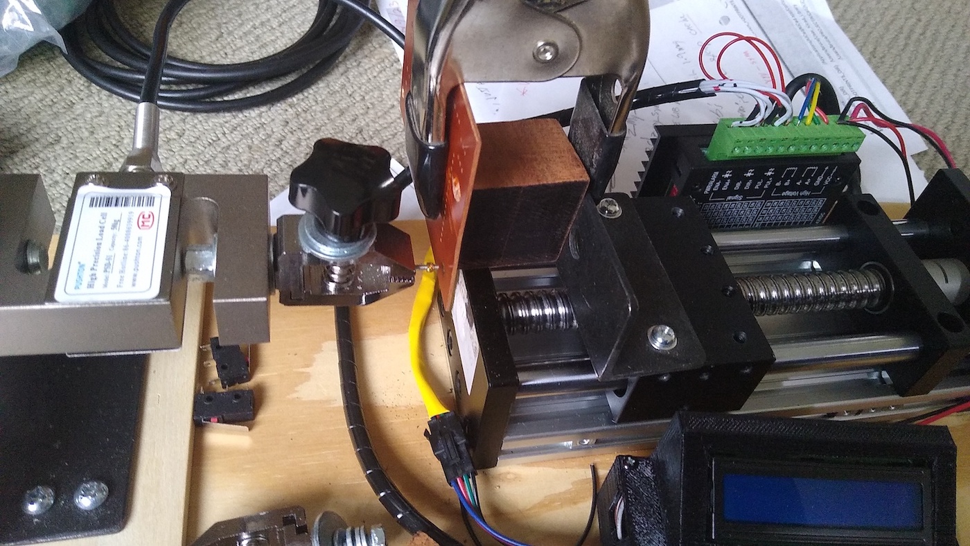

I needed to know the Holding-Force capability of Threaded Inserts in PCB for a project.
That compelled me to design a gizmo. Sure, I have hand-held force measuring gizmos but wanted something more repeatable/accurate with ability to Plot the data/curve…
For the Test, I used PCB’s with same size Holes and M2-H2 threaded inserts.
Some Inserts were manually Cold-Pressed in. Some used Heat-Pressing (using a standard tool & Soldering Iron).
I all cases, the Cold-Pressed Insert held far better than the Heat-Pressed Inserts - about 2x stronger. Tests were fairly repeatable.
I tested only One size - the one’s with compatible height of 1.65mm PCB.
The design uses two Arduino Nano’s because: I have a couple dozen of them in a box, wanted independence of “Interrupt’s” for Micro-Stepping (32 steps per pulse) and, more importantly, I use Arduino’s ‘Plotter’ which kills the Stepper motor performance…
(NOTE: There are different styles/brands of Inserts - I tested several and chose these (screenshot))
I can understand this.
Heating those rings will expand and cooling will contract. With respect to the outside surface, the interference fit of a fitted heated ring will not be quite such an interference fit when allowed to cool compared with a cold fitted ring. The opposite for the internal surface.
Thanks for the result table, I’ve sometimes wondered about the strength capabilities of these inserts. :slightly_smiling_face:

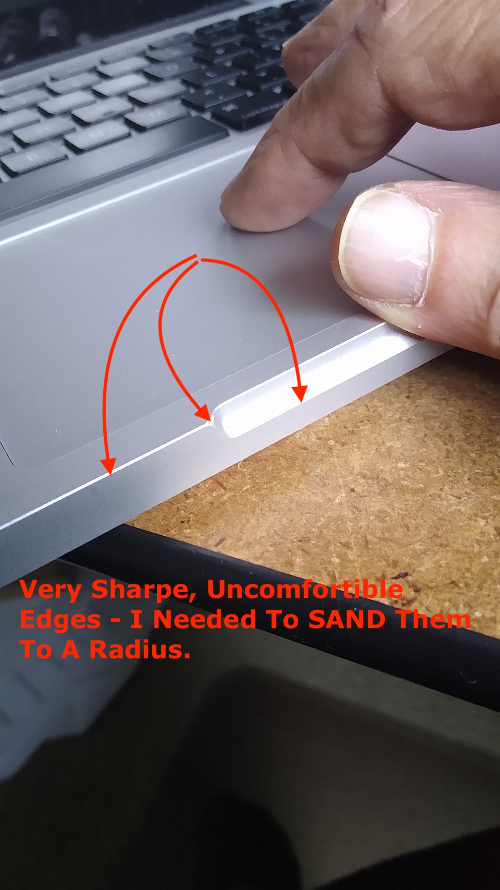

On the other side - folks I know doing electronics usually need some kind of container/enclosure for their PCB and using KSU/StepUp makes it very convenient. Without good knowledge of Mechanical design, an Electronics-Product based Engineer can easily push out crap (from the physical/mechanical perspective). I have an Apple Laptop with terribly sharp corners/edges that if an Average Mechanical Engineer looked at it, it wouldn’t have gotten out the door.
