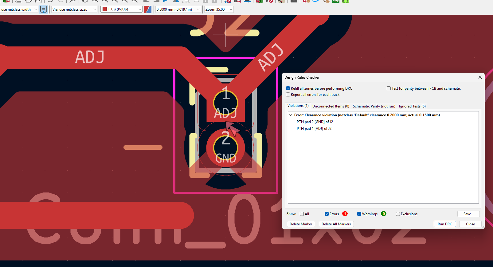

Im having a clearance violation between a 2x1 header generic footprint. May someone help?

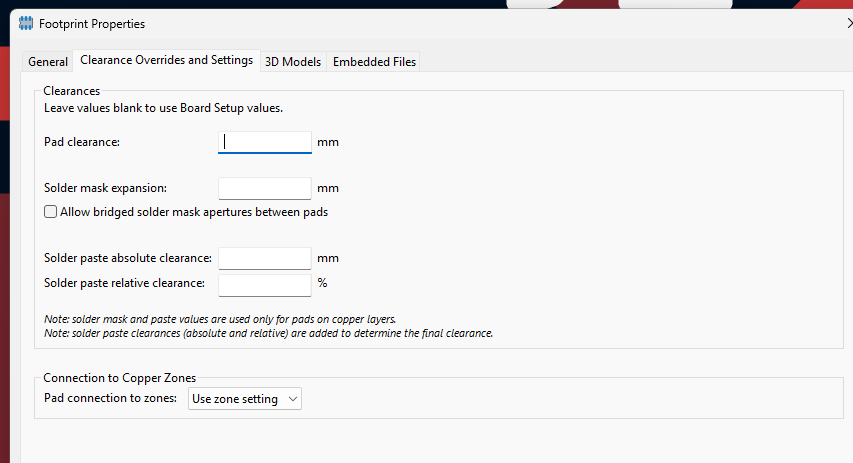

There are nothing configured on pad clearance, so Im thinking its the default.

Measuring at screen it looks like 1mm pitch connector. I have never used such. I suppose they are not compatible with 0.2mm clearance.
there are another header I can use?
Found a 2mm pitch header. It solves the issue. Thank you very much.
I will pay attention in kicad defaults clearance now.
