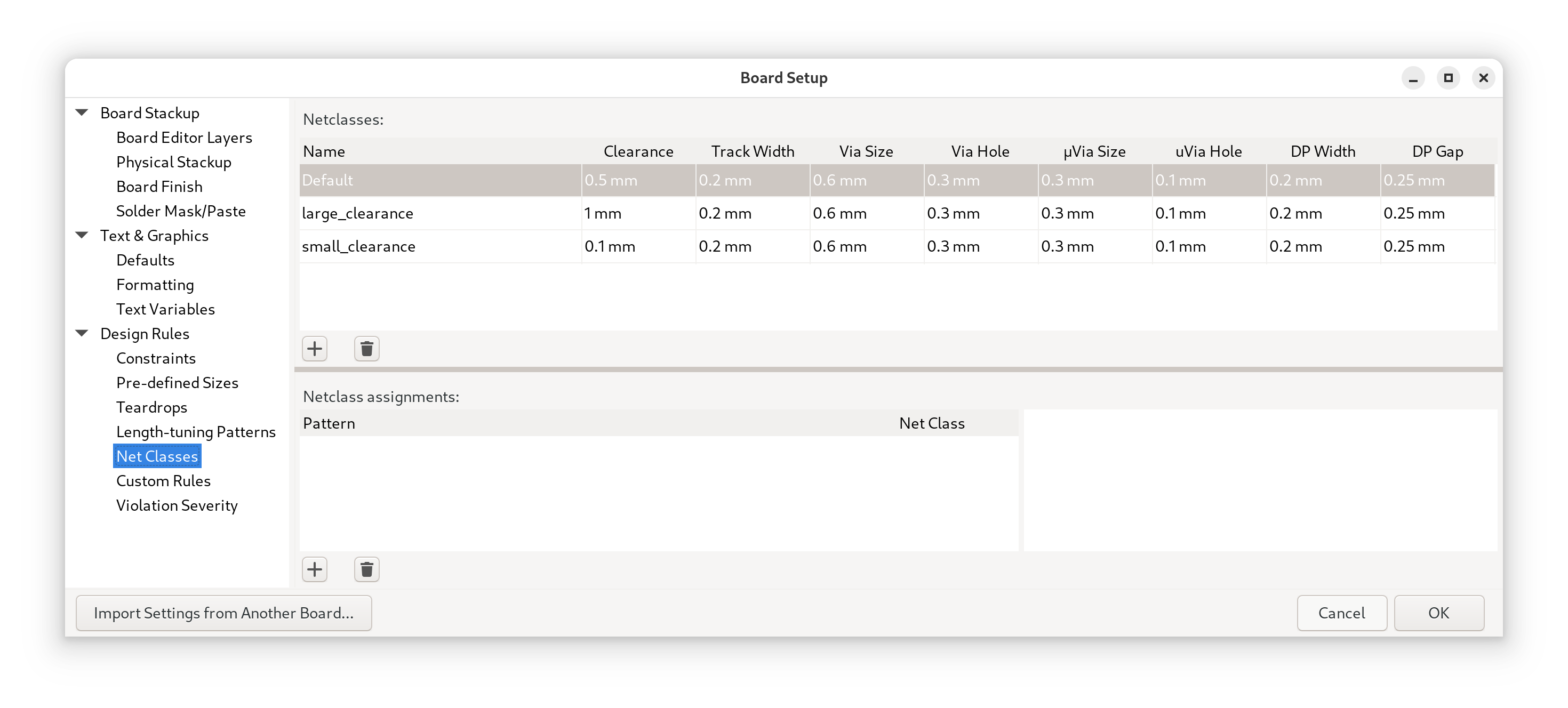

In the PCB editor settings I defined the following clearances:
and when I make the PCB I get this:
As seen, the clearance of small_clearance is not what I would expect, since it is taking the one from the default netclass:
The settings in the zone fill are:
and the design rules constraints are:
If I change the clearance of the default netclass to 0, then things work fine, i.e. small_clearance uses its own value. I have seen this happening in multiple PCBs.
Is this the expected behaviour, or a bug?

In KiCad 0 frequently means “get this parameter from more global setting” and in the case of clearance between two objects one having bigger value wins.
I have never used 0 in zone clearance. I would suppose 0 here could mean use default clearance of the net. Do GND belongs also to small_clarenace class?
I would say GND belongs to the default class. I have not assigned it to any.
I get the point of “larger clearance wins”, which makes total sense for things like fabrication tolerances and high voltage clearance, etc. In my case, however, I am dealing with RF so I need a very specific clearance for impedance matching.
Select the GND zone and the “small clearance” track at the same time. Open Inspect → Clearance resolution. You’ll probably find the answer there.
