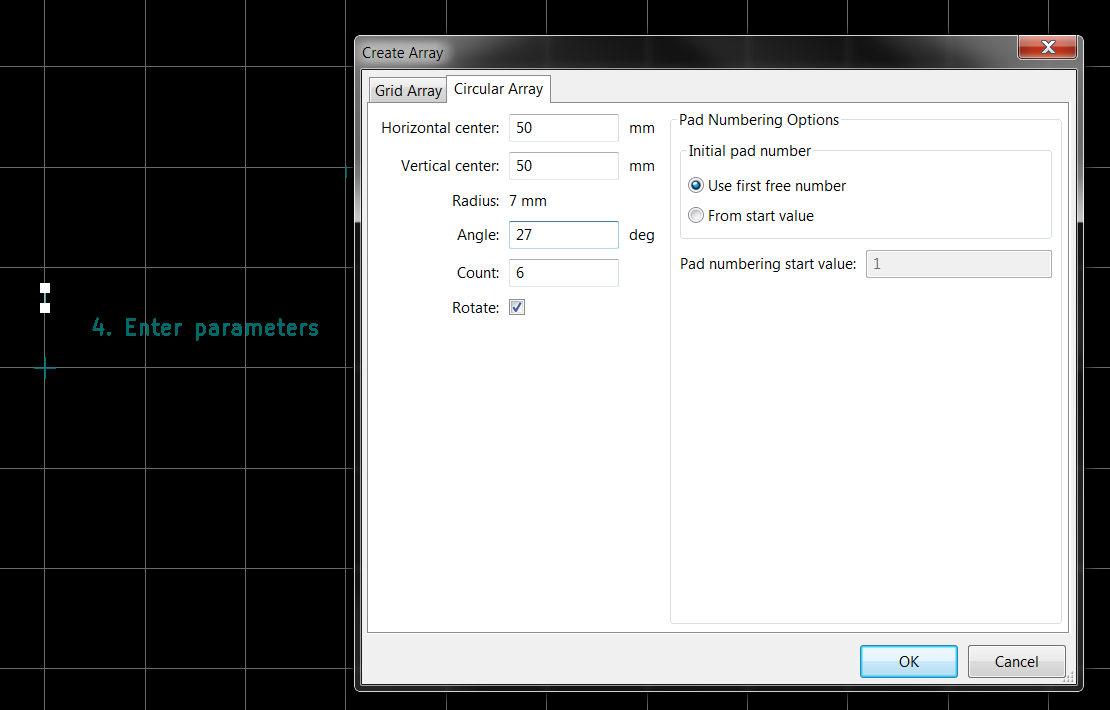

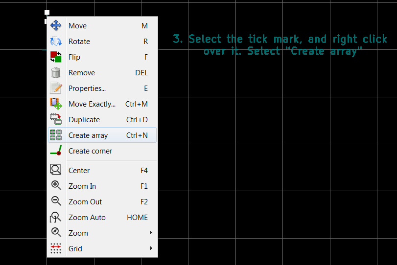

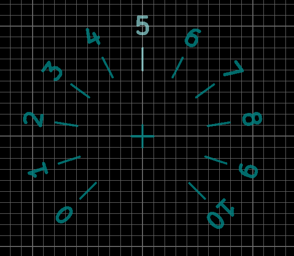

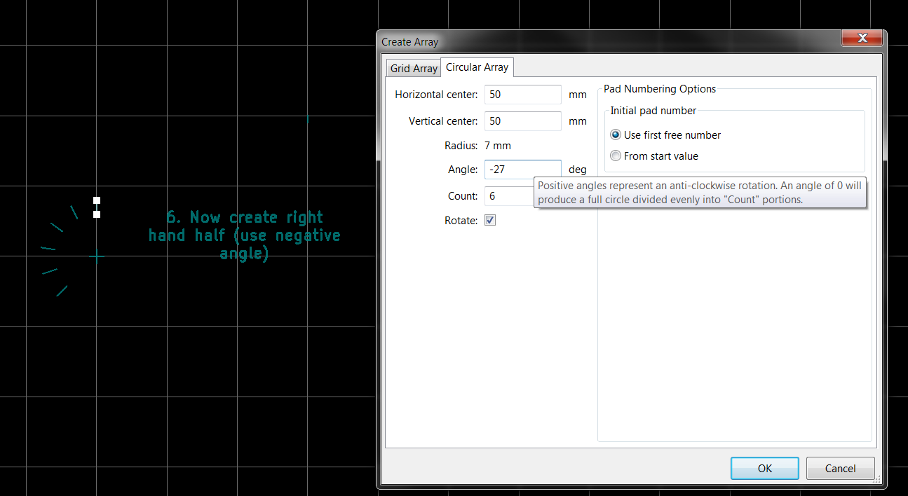

One thing I cannot understand: is this tool designed only for drawing circular footprints, or is it also suitable for placing components in a layout? Reading the quoted Bobc post, it seems that one should first draw the ticks (where the components will then be placed) by the Circular array tool…then there should exist a way for “attaching” the components in the layout to the previously drawn ticks…or am I wrong?
Testing the same function in Eagle, it seems that there is a much more strict relation to the schematic, because the components are circularly grouped in relation to the schematic part names (while it seems that in KiCad this relation is completely missing).
Or, am I wrong?
