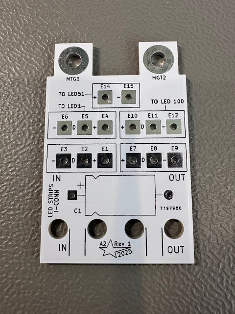

Circle Tool for NPTH
Just starting to learn KiCad and I needed some NPTH for tie wrapping some cables. I saw a video using the Circle tool and it seems to make a nice NPTH if drawn on the Edge Cuts Layer and it’s viewed in 3D. However it’s not showing up on gerbers or drill table (map). I put a drill table on F Fab layer adding the missing NPTH and also put a note on a added dimension pointing to the holes. I hope the PCB house actually reads this Fab drawing and picks up on this. Is there a better way to add NPTH so they get added to gerbers and Drill Map? Tx!
Circular holes should be in the drill files which are usually Excellon format and have the suffix .drl. Do you not have the PTH and NPTH ones? Not sure about drill table map, I never used them.
So that the strange thing, the Circle tool was used in Edge.Cut where I have the board shape outline. There I added 4 NPTH and they looked good and in 3D viewer they looked good too. But the generated the drill berbers (in the Plot dialog) did not show any holes and yes there were two files generated one for PTH and one for NPTH. So I looked at the drill map and the chart showed the plated thru holes for the component pads but did not have any NPTH holes shown. So I guess the hole made from the circle tool is not considered a PTH or NPRH. Maybe it’s a route and not a drill. Not really sure which is why I’m asking about it.
This is my first PCB in KiCad and very simple one at that just to learn it. I’m a long time Altium user but not working now so don’t have access to it like I used to. Deffinietly need to get used to (relearn) some things. Like the Drill Drawing which Altium generated had all the drill and symbols on the board to indicate where each SIZED drill went. I don’t see that (yet) in KiCad, feels strange not to have it. Anyway I just released this PCB to ALLPCB who I used a lot in the past and soon I’ll see if those holes with Circle tool are drilled… hoe so or I got to do it haha!
Edge cuts are cut by router, not drills. So - no entry in the drill table.
Ok that’s what I was thinking,… needs to be made from a Pad to be entered in the drill data. Hopefully the top (why front and not top???) and bottom layers berbers contain the data needed to cut the holes.
