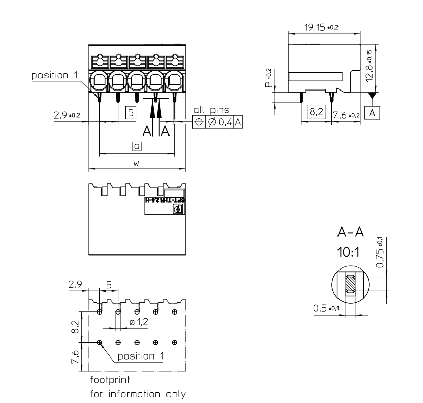

I have to make the footprint for a connector but I’m having a little issue. I don’t find which pad diameter and which hole diameter I must set. Can someone help me please?
I was thinking about setting the pad diameter as 1.2mm and the pad hole as 0.4mm. Am I right ?
The dimensions :
The drawing :
Here is what I’ve done already :

The pin has a diameter of 0.4mm, so your hole need to be a bit bigger.
Minimum from my opinion is 0.5mm. 0.6mm could also be OK.
The pad diameter is related ot the PCB. The bigger it is the better, as long as it does allow to route your board correctly.
So 1.2mm should be OK

Also on you’r datasheet some of the pins are 0.4mm and some are 1.2mm be careful, Check the bottom picture on your screenshot
Based only on picture you showed.
I don’t understand what Φ0.4 means when they do A-A cut at which it looks that pad is 0.5 x 0.75.
And at the footprint (I don’t understand why ‘for information only’) they suggest Φ1.2 hole.

Yes this is why I’m confused about the pins.
Now you mentioned it… the pad seems to be 0.5x0.75 indeed
I begun to suppose that may be when it goes through PCB it is 0.5x0.75 and then for the rest of its length it is Φ0.4. The best would be to have that part in hands, or have a big photo of it.

In the detail of Cross section A-A you can see the pins have a (semi) rectangular size of 0.5 by 0.75mm. All those things in boxes, such as the 0.4mm are tolerances, and that tolerance is for the location of the pin. So the center of the pins are withing a circle of 0.4mm diameter from the their nominal position.
I supposed that this 0.4 in box can be something else than I think but couldn’t get the idea what it can be as graphic with two arrows suggests diameter. Probably it is some mechanical drawing standard convention that all people simply knows (except electronics :slight_smile: ).
I even supposed tolerances, but at A-A there are tolerances written 0.1 so assumed it is not this.
It’s common stuff for mechanical engineering folks and as explained in the wikipedia article, those are tolerances. There are also some measurements enclosed in a rectangular box, and those are the measurements that those tolerances. So there is a grid of 5mm by 8.2mm and the center of all all 8 pins are within 0.2mm (radius) on that grid.
