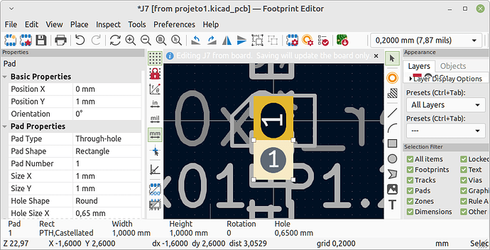

Hi, everyone. I have a product with castellated hole and another hole nearby.
On the picture below, on the left (marked A) is how I’ve already done. It works fine, but I’d like to somehow improve it. What I most dislike is that on schematics I have to have two itens and I need a track between them. Again, not the end of world, but I want to improve it.
For so, I’ve tried something like the castellated hole on the right (marked B). It has only one item in schematics, but I could not make an ideal footprint. I tried to merge two holes in footprint editor, it seems it will work but definitely not ideal (eg, as the arrow points that the GND pad is not fully solid).
I’ve attached a snap of the project if you can have a look and suggest any insights.
Thank you very much!

Luckily you are still using KiCad V8 (or older) so I could open your project and look in it.
I see that you created two overlapping pads for the “B” variant, and that is good. The only thing you missed is that only one of the pads has a pad number. Give both overlapping pads the same pad number, and KiCad will then make both pads a member of the same net.

Thank you for the feedback. Indeed changing the pad number worked and now the GND pad is fully connected.
