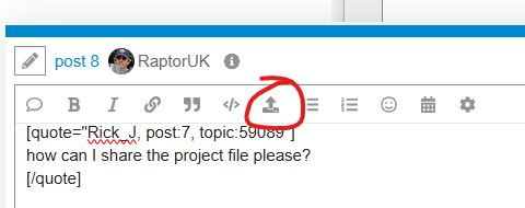

I was able to make this reproduceable over my lunch break - how can I share the project file please?
