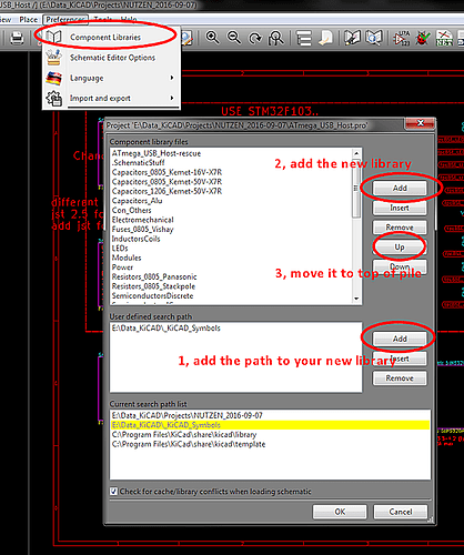

Hello Everyone,
New KiCAD user here. Recently installed 4.0.4 in Windows 7, and I’m not able to add a component symbol to a library or modify a component symbol within a library. I was just about to give up and uninstall KiCAD, but then I tinkered with the library files and came up with a work-around: I create or edit a symbol in KiCAD (or some external symbol maker) and save it as a new file. Then I use a text editor to copy-and-paste the text from each separate symbol file and concatenate them into the library file. Here is r.lib, mc14541b.lib, and tp5089n.lib combined into my own library,

…It’s time-consuming–but it works! My fear is that I’m seriously misunderstanding how KiCAD works and that I’m going to run into bigger problems later. I’ve tried studying the documentation and YouTube videos, to no avail. I think I need screenshot-by-screenshot instructions. Any help would be appreciated.

To do it the (current) KiCAD way of having your own symbol lib you do the following (be aware that eeschema/pcbnew handle things differently, eeschema is old style, pcbnew is new style):
  • open the Symbol Editor
  • load an old symbol/start a fresh one
  • save the symbol in a new library as per screenshot
  • now back in EEschema open the component library setup dialog (which is really outdated and backwards)
  • add the path to the new library (by using the center list)
  • add the new library itself (by using the upper list)
  • move your library to the top of the pile, as currently if you got 2 different libraries with 2 times the same named symbol in there, EEschema will ALWAYS load the one from the lib that comes first in this list
That’s it.
Now, if you want this to be done for ALL new projects which you start in the future you have to do something manually and edit the kicad.pro project template file here (at least that’s how I do it, maybe @keruseykaryu chimes in if there is a GUI way):
C:\Program Files\KiCad\share\kicad\template
I only use my own local libs, so you would need to copy the content of your current projects symbol lib related stuff into that one. The area you want to focus on looks somewhat like this:
For footprints this is different and should be way easier with the footprint libraries wizard or the footprint libraries
manager (I prefer that one).
The manager does allow you to set up both project specific and global footprint sources for all projects you got and there is a way of using variables for paths, which makes your libs easier transferable if you need to.
But more on that when you need it, I think you will doing fine with footprint lib setup on your own.

That’s the part you want (under 2.2):
http://docs.kicad.org/stable/en/kicad.html#_initialization_of_the_default_configuration
Run KiCad and load kicad.pro project.
Run Eeschema via KiCad.
Modify and update the Eeschema configuration,
and mainly the list of libraries you want to use each
time you create new projects.
Run Pcbnew via KiCad.
Modify and update the Pcbnew configuration, especially the footprint library list.
Pcbnew will create or update a library list file called footprint library table.
There are 2 library list files (named fp-lib-table).
The first (located in the user home directory) is global for all projects.
The second, if it exists (located in the project directory) is specific to the project.
It boils down to opening the kicad.pro template file with KiCAD, doing all necessary adjustments to the paths via GUI means as I described above and then saving the all changes to the kicad.pro file via the 2 KiCAD tools AND also via the application launcher main window (save in eeschema, save in pcbnew, save project in KiCAD)
