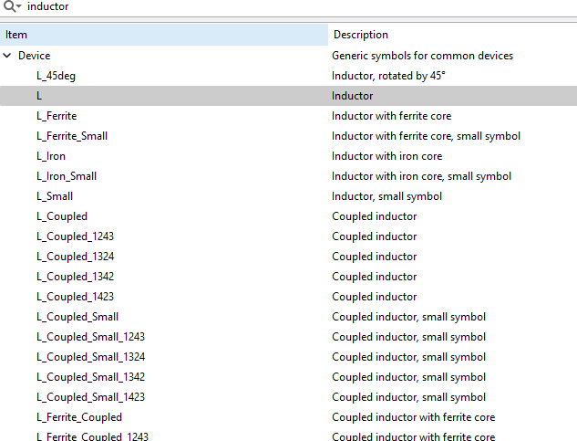

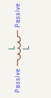

The Kicad Symbol Library containing these basic symbols is named, and nicknamed, “Device”.
All the basic symbols you need and the most common SMD footprints should already be installed from a full KiCad install. What is your KiCad version?
KiCad does not use the unified Part" way of doing things. Generally you use generic symbols, add a value and then choose a footprint - in your case Inductor_smd is a start

That’s footprint related . . . not schematic symbols, symbols are symbolic not related to real physical sizes.
