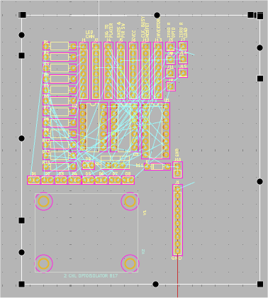

1 - I cannot now draw a rectangle on the pcb editor. I have used the pull down menu and the RH menu.
All I get is the below image (a purple rectangle), which basically does nothing.
2 - I have to use the draw a line, which can result in split lines, as image below. This split rectangle has been made into a polygon, by using ‘create from selction’ ‘convert into polygon’. But I cannot create a polyline that is closed. Any ideas please.
Have you gone through the Getting Started tutorial in KiCad documentation? We don’t want to keep your hand through the very basics.
Right bottom you have Selection Filter. If because of it elements you try to select can’t be selected than your selection rectangle really does nothing.
I have seen such picture only when editing zone. But I am still in V8 and may be have not seen some new features.
To draw a rectangle, select the tool. Click the mouse button at one corner. Move the cursor to the opposite corner. Click the mouse button again. Done.
Dragging the mouse with button pressed is used for multiple selection.
Purple rectangle may be a “locked item shadow”.
