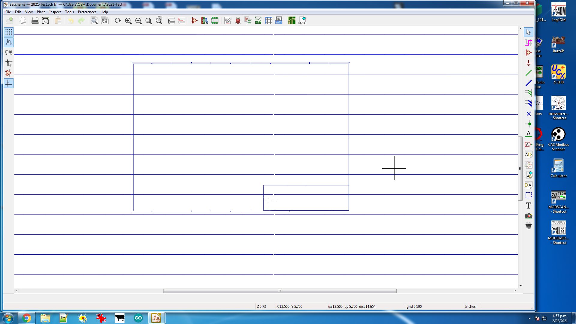

Just downloaded Kicad version 5.1.9. and opened a new schematic:
If I select preferences/display options / dots then the screen is full with horizontal lines, NO dots.
If I select preferences/display options / lines then the screen is full with horizontal and vertical lines.
If I select preferences/display options / small crosses then the screen is full with small crosses.
Any suggestions?

Also, a screenshot and version info would be useful.

Screen shot attached

I loaded Kicad on another desk top (Win10) and the schematic now displays the dots
