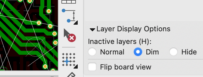

Can you set the dimming factor of inactive layers?
While routing a four layer board, the tracks get very busy. There is this handy radio button that dims the layers you are not working on:
DimmedLayers
However, then i can hardly see them. Unfortunately my eyes are not what they used to be, so in the past this was probably not a problem. Is there a setting somewhere so you can turn this up just a little?
Thank you for any help.
Preferences->Common->High contrast mode dimming factor.

Fantastic, thank you for your help indeed!
It’s not that i did not search, but i must have overlooked it (It is under KiCad|Settings|Preferences|Common. The “Preferences” menu is about paths in my version)

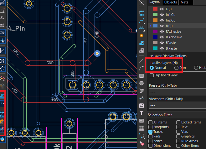

In the case of multiple layers, this is just my personal opinion, but I feel that if the color changes every time the working layer changes, the continuity of the afterimage in my mind becomes weaker, so I work using settings like this.
Sketch Tracks
Combine the color theme and the following settings to find the environment that is easiest for to use.
  • Inactive Laayers Normal (H)
  • Sketch Tracks (K)
  • Sketch Pads
  • Sketch VIas
    can also switch between them using the shortcuts HH…/K.
