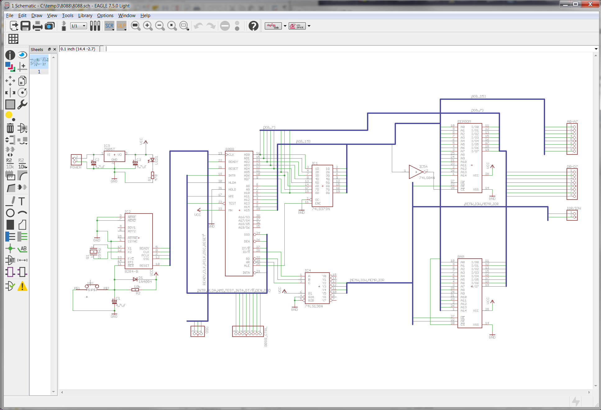

The buffers overlapping other symbols look strange. Is this the problem mentioned by @Seth_h or is this a problem of your particular conversion?
The same issue appears in the viewing utility I based my converter on; I suspect it is the same issue mentioned above.

Looks ok in Eagle 7.5.0, I suggest it is a problem with the conversion.
Schematic saved in XML : 8088.sch (657.4 KB)
thanks for the attached schematic, it should help in debugging the conversion code.
