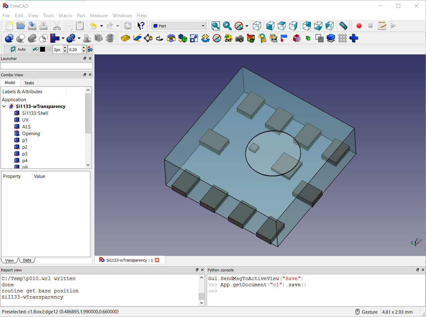

I created a quick 3d model (incomplete) but wanted to see it in kicad before putting to much effort in.
alas: installing maui phyton script.
But as i cannot move my objects in one single move i tried to save it 1:st as wrl and secondly as step.
But step need to be with all objects unified as one (connected ?)
I dont know how to get this in as a single object.
screen shot from freecad with its native format FCstd and a loaded module shown

"- convert your model to STEP in scale 1:1
  • assure that your STEP module is fused to just one solid object"
The above is what I don’t know how to do.
In FreeCAD make sure the Part module is active. Then in the Edit menu, choose ā€œSelect Allā€ and in the Part toolbar select the ā€œUnionā€ button.
Merging (fusing) your object is done in the part workbench.
Select all your objects and choose the boolean operator fusion.

I wanted the optical sensor areas marked out that’s why I got started and then the need to make a diffuser
Hi, Maui
this chip body (an optical sensor) should be clear plastic so the sensors can be seen inside
but that doesn’t seems to work
unsupported ?
Si1133.FCStd (17.3 KB)
If you use VRML and keep the opaque parts as a separate object within FreeCAD before exporting it, you can ā€˜safe’ the transparency (works in nightly 2016-09-17). Didn’t try STEP in KiCAD yet, but maybe you can set different faces to have transparency (as you have to unify it), but I wouldn’t count on it.

To make it work for VRML one has to select the parts that need to be opaque and set their transparency option to less than 100% in FreeCAD. Don’t know if STEP does support something like that…
Another workaround might be to have 2 STEP parts for your device and load both in your footprint definition. One opaque and the other solid. KiCAD will put them over each other and should behave…
Re: STEP and transparency - no, STEP does not support transparency; after all it is intended to pass CAM data and not visual information. I guess VRML will survive in KiCad for some time then even though I never use it. But who knows - STEP is always changing and someone might stuff a material appearance spec in there.
Hi @nicholas
you can conserve transparency in wrl both on kicad stable and kicad nightly if:
  1. create your model in FC assigning transparency values to subparts
  2. select all parts and export those with kicad StepUp (you can export without wrl material check or with wrl materials… in case you select to export with materials, you have to assign ā€˜asis’ to transparent blocks)
  3. create a simple copy with FC Part and fuse all the objects, then export the step model and don’t overwrite wrl model.
    Si1133-wTransparency.FCStd (52.2 KB)
Si1133-transparency.wrl (36.5 KB)
Si1133-step.step (270.7 KB)
Please consider that STEP doesn’t support transparency, so you will not have any transparency on 3d viewer assigning 3D STEP model to your footprint.
The best option IMO for aesthetic and mechanical design is to use WRL (coming from STEP model) in kicad 3d viewer and STEP for MCAD.
