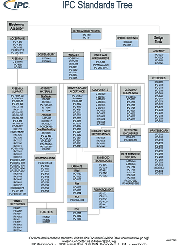

Here’s result showing a full Enchelada…

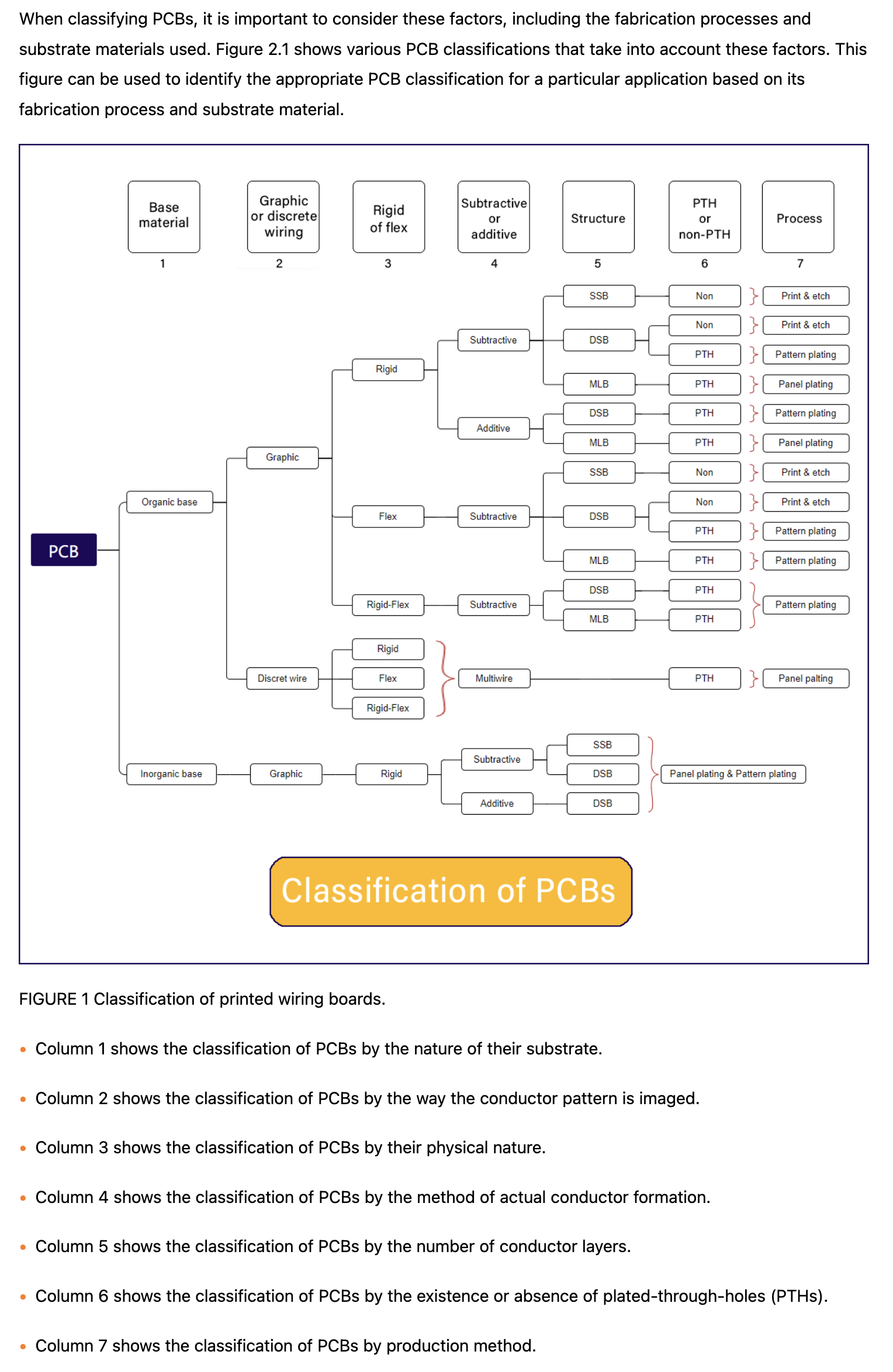

ADDED: A Classification Chart (that goes beyond Class3)…
ADDED: Reference to IPC 2222B - showing classes 1-thru-6
