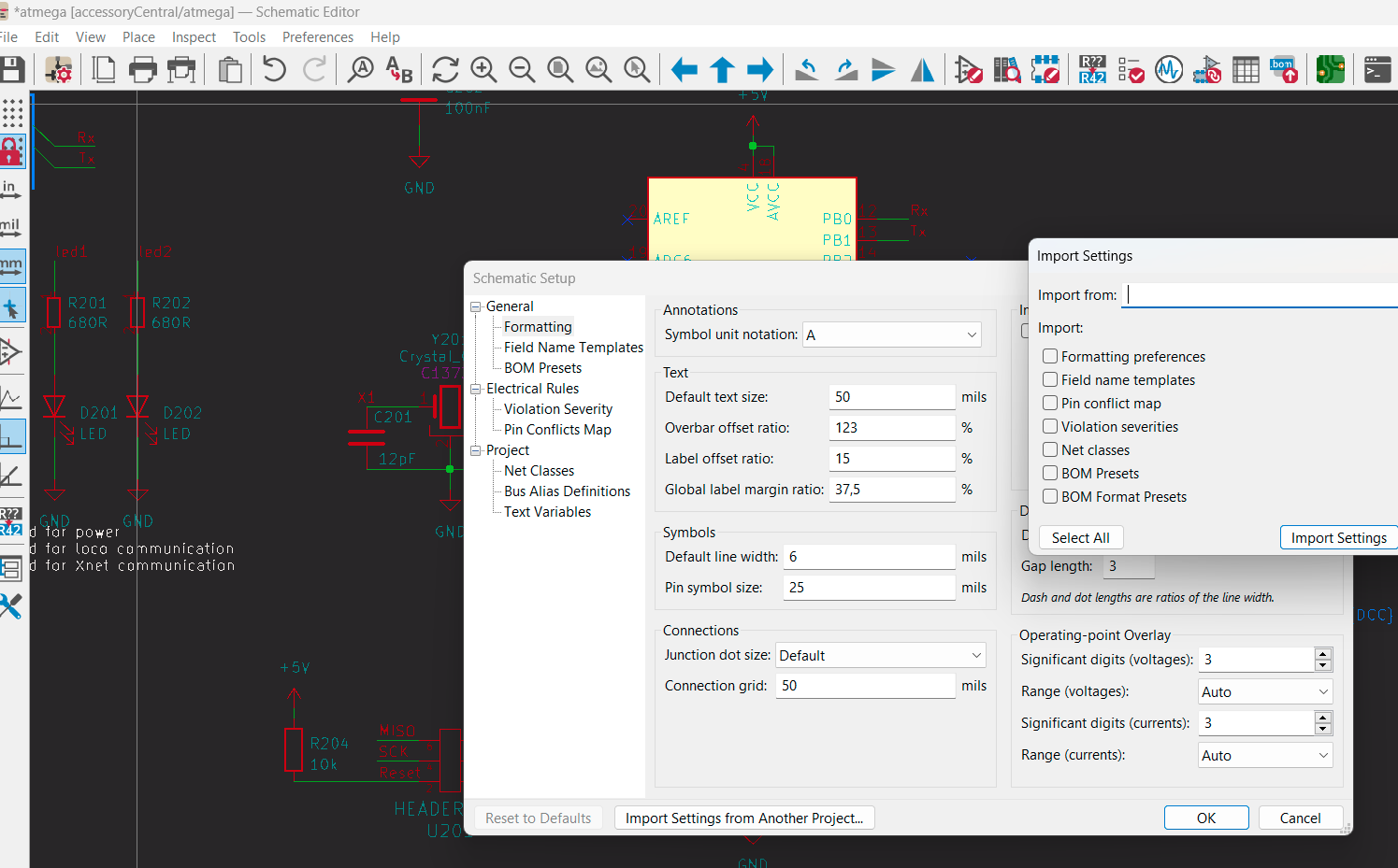

Entering new members in the Bus Alias Definitions lists is indeed quite cumbersome.
True, but you can alter your workflow so you have to do this less often.
You can make yourself a default template. If you start a new KiCad projects, just copy past your template project. Or whatever means KiCad has concerning templates. This template you should keep up to date whenever you create a new bus alias in some project.
The idea is that your template will grow with aliases with every PCB you make.
I do this alot for schematic sheets and pre-routed parts of board I can recycle.
An other option is to import the settings from this template project. This is what I do. If I import my template I can use the {I2C} bus without having to make the alias first.
And yeah sure, you will always have some buses which are just married to that one single project. I am in favor of your idea to automatically add members to the bus when you create a new label. Or a ‘make new member’ option when you right click a bus or something…
