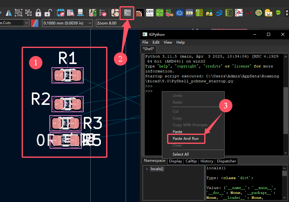

Geographic reannotation is more limited, schematic annotation gives more freedom.
import pcbnew
board = pcbnew.GetBoard()
footprints = board.GetFootprints()
counter = 1  # 从1开始计数
for footprint in footprints:
    if footprint.IsSelected():  # 只处理选中的封装
        reference = footprint.Reference()
        footprint.SetReference("T_" + str(counter))
        counter += 1  # 递增计数器
pcbnew.Refresh()  # 刷新画面
