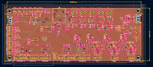

Today I have an odd issue. When I open a PCB file from the PcbNew app directly, the board looks as it should:

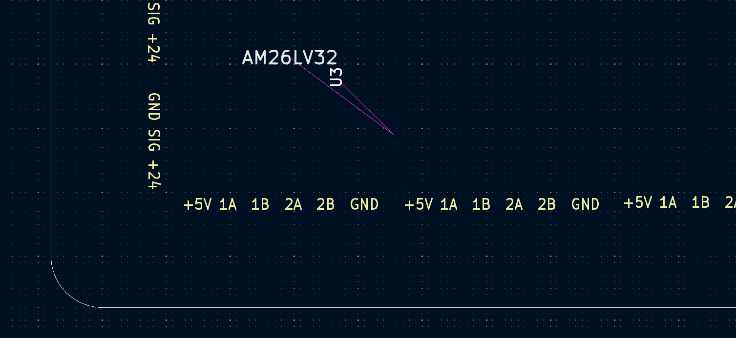

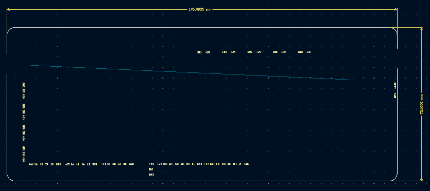

When I open the PCB file from the normal “Project view”, it opens up to show a more or less empty board like this:
This is the same file. I cannot select any footprint in the PCB Editor, but if I highlight a component in the schematic, it will show the Reference Designator and Value fields like this:
To me, it looks like the rendering is crashing but without any error message. I originally used v9.0.2, but I upgraded to v9.0.3 to see if that would solve the problem. It did not. Is this a known issue? Any hints on how to solve it is much appreciated! I’m on an Intel based Mac running OSX 13.1.

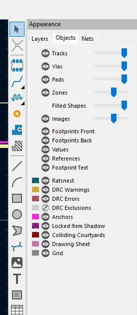

This is because your appearance settings are messed up. Enable them again or delete the *.kicad_prl file
There was a bug which caused a situation like this when opening an older v8 file in v9. It has been fixed, but I think it can still affect the view if the project was already saved with an older than 9.0.3 (or older than .2 or .1?) version. As far as I can see, it just used and wrote wrong visibility values to the .kicad_prl file. Deleting that file is safe, it’s just the GUI state etc. which doesn’t affect the actual design.
