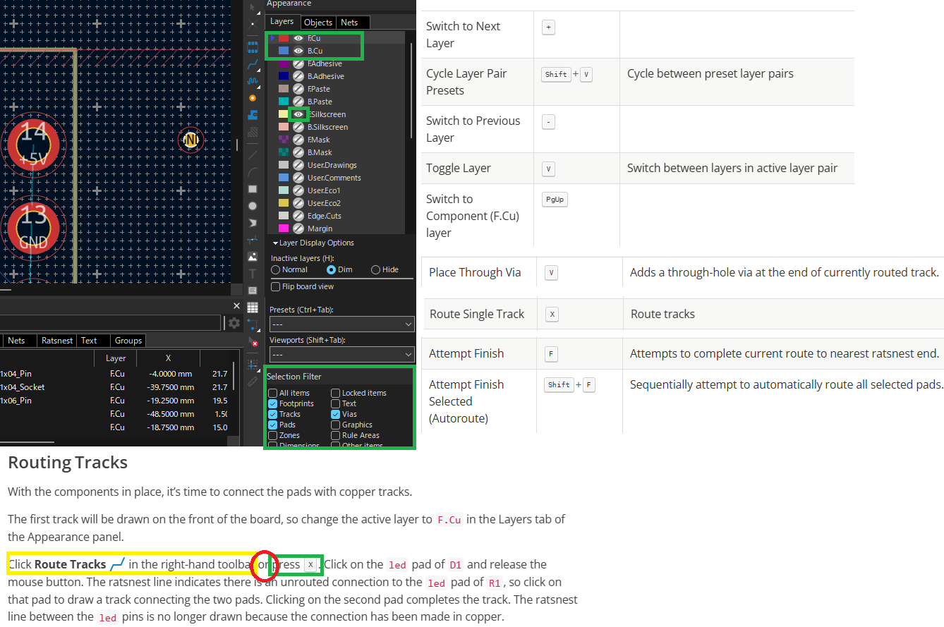

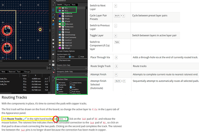

Depending on your selections here
you may have problems selecting the “bad” object to delete it.
This can happen if you mistakenly select the “draw lines” tool instead of the “route track” tool here
For information on working with Routing Tracks, see the official documentation: Routing Tracks
Click Route Tracks to add tracks in the right-hand toolbar or press X.
"press X". will you work more efficiently once you become familiar with it.
Actions reference (PCB Editor)Actions reference (PCB Editor) in the Hotkeys chapter.

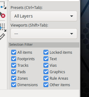

Additionally, adjusting the selection filter panel and board layers settings to suit your needs will make your work easier.
ex.
may also want to consider using “Cleaning up tracks and vias” and “Update Footprint from Library”.

Further poking around displayed the Type of the first segment ONLY of the “track” was in fact NOT “Track”… confirmed as dislayed in the bottom status bar. The other segments were. Which explains why when I had the several segments of the track selected, I got no Properties… objects of different type were selected. Makes sense… My selection filter had all (except locked) item types selected.
