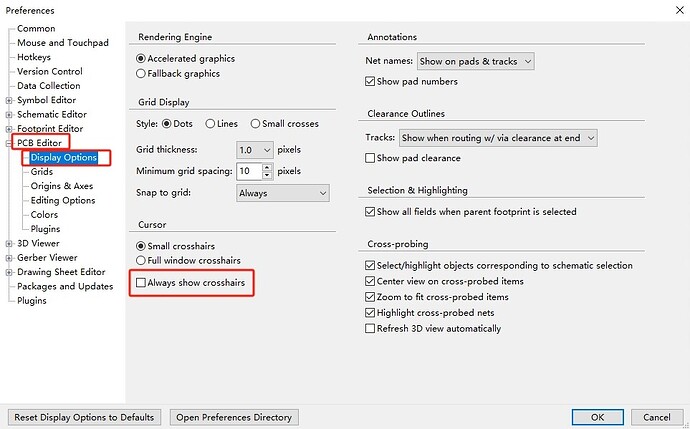

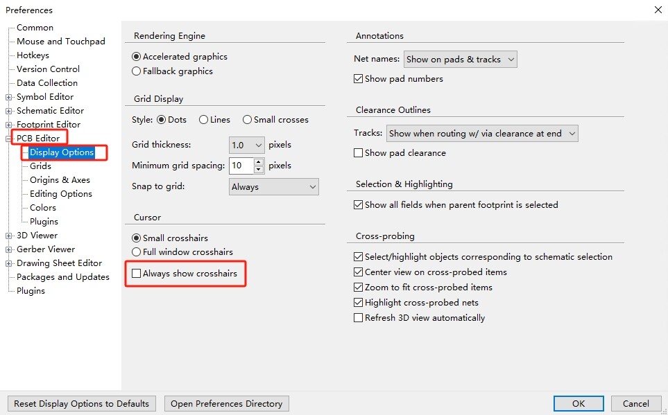

Bug: Disabling "PCB Always show crosshairs" breaks Footprint Chooser preview in schematic editor

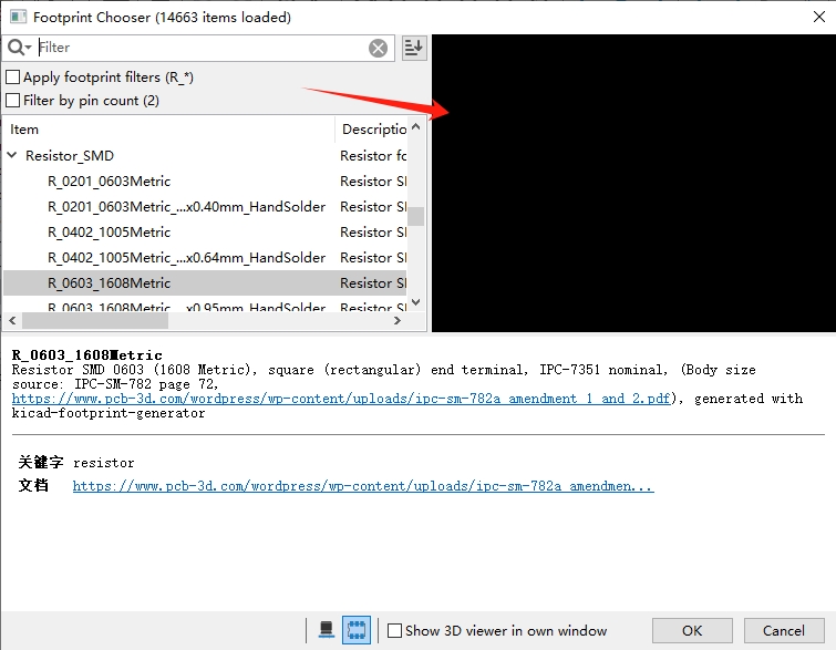

Disabling “PCB Always show crosshairs” causes a bug where the preview on the right side of the Footprint Chooser does not display any content when selecting packages for symbols in the schematic editor.
This bug occurs in versions 9.0.2 to 9.0.3.

I just noticed that the thread title refers to the Schematic Editor when it should refer to the PCB Editor.
Selecting Symbols in the Symbol Editor works perfectly.
