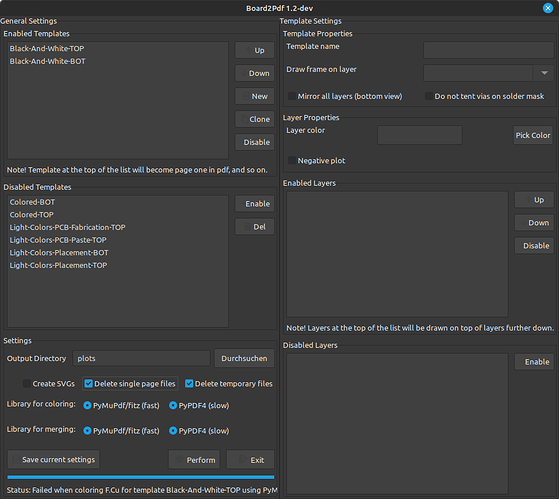

Hi albin,
just installed the new commit, but i can’t choose. The PY radio buttons are all highlighted :

@tTom Thanks for testing! I’m glad that you found this and that I didn’t push this version to the PCM yesterday. :smiley: Not sure why it behaves differently on Windows and Linux, but my implementation of the radio buttons where not that great.
I’ve pushed a new commit where this is hopefully solved. I see no difference in Windows. Please test with the latest commit.

Hi @albin ,
its my pleasure, that i’m able to do something here with my small knowledge. I’m still proud of that i can put your commits to the right place for troubleshooting :smile:
Now the radio buttons behave as expected, and pdf files were generated (pypdf4), wonderful !!!
