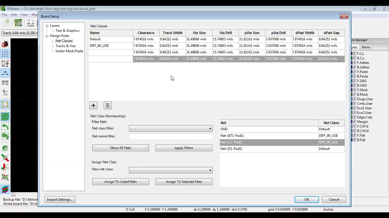

Clicking the “Board Setup” icon below the menu causes the main PCBnew window to lose focus, but no dialog appears. I’ve looked on the taskbar, and alt-tabbed, but there is only the PCBnew window and the Kicad project manager window. Clicking anywhere in the PCBnew window results in the error sound. Pressing escape returns to normal operation.
I can see how it is supposed to look, so why is my Board Setup dialog not displaying?

The screenshot you posted to has the title: “Edit text and Graphics Properties”.
This is not the “Board Setup” to edit the design rules.
Pcbnew / Edit / Edit Text & Graphics Properites
Pcbnew / File / Board Setup
All those dialog windows are usually forced to the front (and therefore also the “main” Pcbnew window looses focus) This is by design to prevent complex interactions of opening multiple such windows at the same time.
It may be that you have tweaked your OS, and the dialog is drawn “under” the main Pcbnew window if you do not see it.
paulvdh, you’re right, I linked the wrong image. Fixed.
And I think you’re also right about the board setup appearing “under” the main window.
