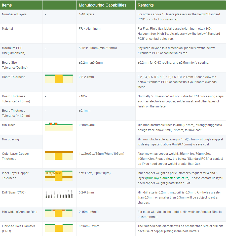

This is my first time manufacturing a PCB, and I’m unsure if I’ve set up my constraints correctly. I’m planning to use PCBWay. Here’s what I’ve done so far:
And here are their capabilities:
Could you please verify if everything is set up correctly? here is also a link to their website: pcbway - capabilities I am not sure if it should be 0.15 or 0.1524? if I choose 0.1524 i get a lot of errors as most of the holes are 0.15…

A min annular ring of 0.15mm (pcbway spec) and min hole dia of 0.3mm (reasonable) means a min via dia of 0.6mm (not 0.5).
I would also recommend min track width of 0.2mm and min clearance also 0.2mm. I often use 0.25mm tracks when a layout is not tight.
You can do finer tracks/vias/holes when needed, but it may cost more.
Copper-to-edge of 0.4 or 0.5mm is reasonable.
Silk (text thickness and lines) should be 0.15mm min (not 0.08). 0.1524mm is 6-mil (0.006 inch) and that is a holdover from US standards being 6-mil min silk width. I have all my libraries set to 0.15mm and have never had a problem with pcbway or jlcpcb making boards. I like my silk text to be 0.64x0.64x0.15mm.

The “minimums” from any PCB mfg are exactly that. They are something you only use if you have no alternative. They should not be used as a “default”. So depending on the density of the copper runs I would use 0.3 mm as my minimum track width and I would double (or more) the minimum annular ring. This last suggestion is more for prototype boards and not production boards. A small annular ring will be difficult to UNsolder if you have to change a component or wire.
