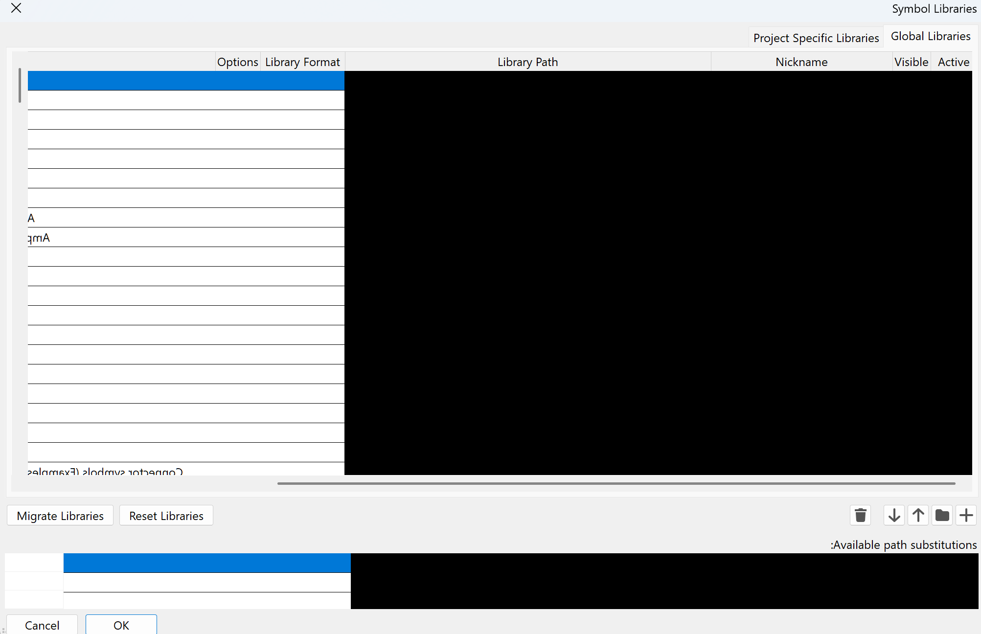

Hello everyone,
I have a problem with kicad when i open manage symbol library the csv is black i cant see a thing, and when i open it the symbol editor also becomes black, it also happens with manage footprint library and footprint editor, is there a fix? this problem happened after i installed easyeda2kicad idk if its the problem or not.
Application: KiCad x64 on x64
Version: 9.0.3, release build
What’s your GPU? What’s your GPU driver version? Can you update it?
Can you remove easyeda2kicad?
gpu: Intel(R) Arc™ Graphics
driver version: 31.0.101.5522
yeah i can uninstall easyeda2kicad, but i doubt its the problem i installed it via python pip
You can try updating the driver first from
https://www.intel.com/content/www/us/en/download/785597/intel-arc-iris-xe-graphics-windows.html
it didn’t change, still the same problem
ahh fixed it was a problem with the language i think, when i changed the language in kicad it fixed it, it was set on arabic thats why
If Kicad is meant to work wit RtoL languages, this may be a bug.
