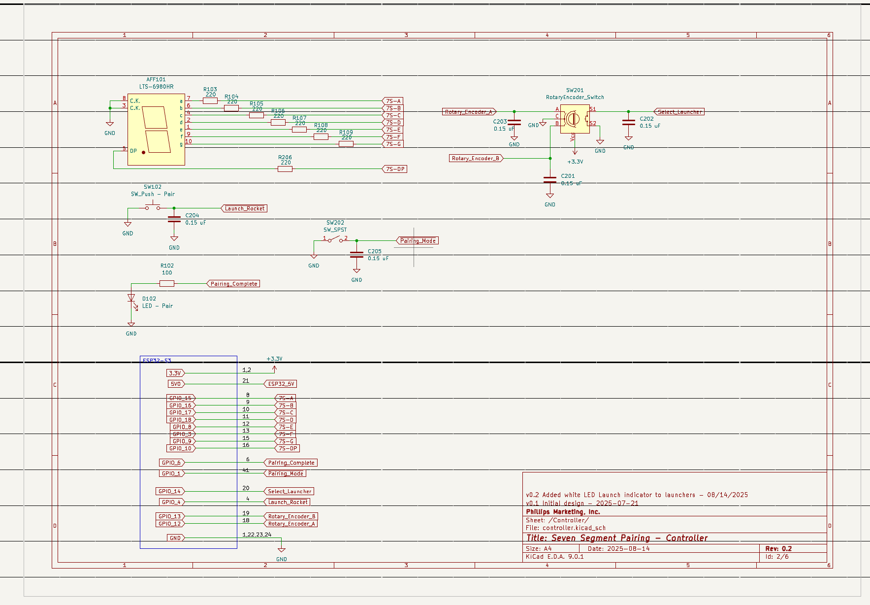

My computer broke, and while I am fixing it I have been running off a persistent Ubuntu 24.04 Live USB drive. I installed Kicad 9.01 and was able to open the projects I am working on. However, now the schematics open with black horizontal lines. All the components are there, just these annoying black lines. When I plot the schematics, the lines are not there. Any suggestions on how to remove these lines?

In previous versions there were setting to use accelerated graphic or not.
As I remember people asking here about some corrupted view changing this setting was what helped them.
First I’d upgrade to 9.0.3 and see if it’s a bug that’s been fixed.
Failing that under Preferences / Preferences / Schematic Editor / Display Options.
What is the rendering engine and grid display set to?
Mindful that you’re working off a Live USB drive, this has all the hallmarks of a GPU driver issue. Are you able to update to the latest for your hardware?
Also, what is the full KiCad version info?

Thanks to @gmc, I set the rendering engine to fallback, and it solved the problem.
