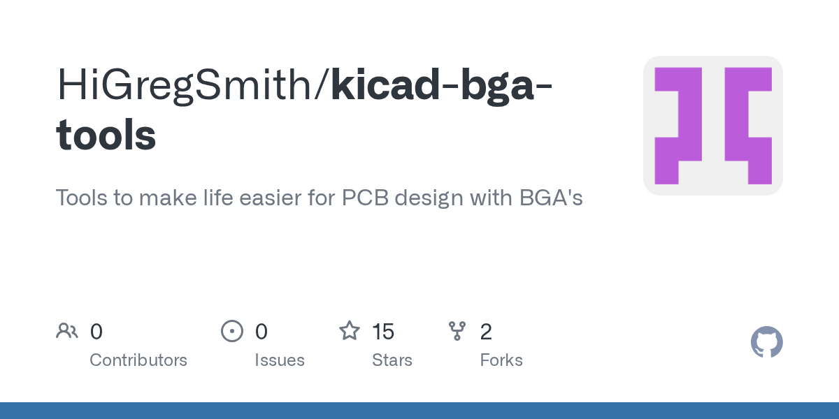

Take a look at this project:
It’s working for me for BGA fanout. It’s a python plugin…
