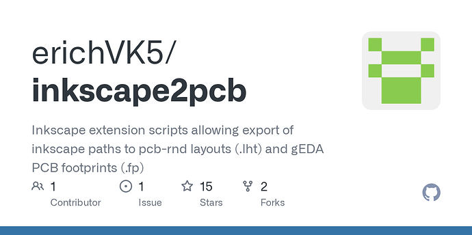

No, and after a number of discussions on the dev list we have an almost unanimous decision not to support beziers as such. Ideally if we import any curves which contain Beziers we should convert to a series of circular arcs; hopefully that will be done one day, but there is a lot of work to do on kicad’s underlying geometry code before it makes sense to do that.

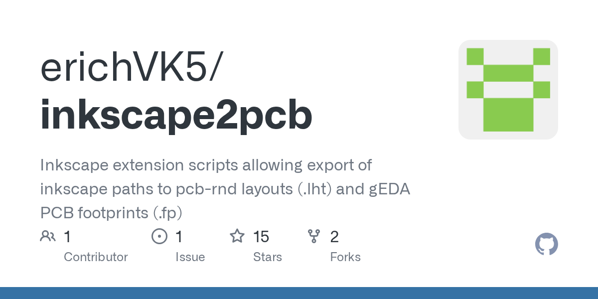

You can use Inkscape scripts like this one to export directly to a 1 px : 1 mil dimensioned footprint in gEDA PCB format, which KiCad can load easily enough:
The chief advantage of converting beziers and cubic splines to line segments is that line elements are supported by DRC in KiCad.
If there is demand, I could create an additional script for export to a KiCad native format.
pcb-rnd and gEDA PCB support arcs on copper, but until KiCad does, conversion to bi-arcs would not make a lot of sense for copper layers.

Why go the route over geda?
Just use svg2mod and get a kicad footprint.
