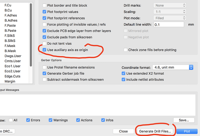

Another way is to plot to .SVG (both the “gerber” and the “drill map”, and then overlay them in a program that understands .SVG such as inkscape.
You get to choose the Reference-Origin (select when plotting it):
• The Default of the Page’s Top-Left corner (called Absosolute)
• The Auxiliary Origin
Both shown below in Red Circles

Two ways to get a “Drill File”: From Menubar and from Plotting Outputs. You’ll need to do some homework (below screenshots might help)
Here’s what I did:
• Added two vias to a PCB (and added some ref dim’s so I could verify locations)
• Added Aux Origin
• Plotted two outputs: One using the Aux, One using default (Absolute) both were plotted using the Plot Tool…
