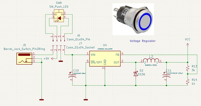

I’m just starting to use KiCad and I’m working on an Arduino powered project that will end up in an enclosure.
I’d like to add one of those Multicomp Stainless Steel Pushbutton Switch to start the device.
However I don’t know how I should lay it out on the schematic. Obviously the pushbutton won’t be mounted on the board, but should I use connectors to plug it into the PCB, or directly solder wires?
Here is my attempt :
Here are my questions :

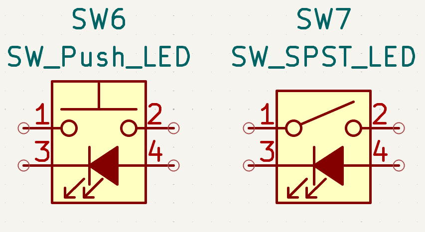

First: Is the SW6 pushbutton the right component ? (It won’t matter since it will be marked as a DNP, it’s just for clear documentation)
Second: Is connecting J6 to J7 like this the right move ?

IMO . . . what ever method you are using to connect the switch to the PCB should be shown in the schematic.
You can have the symbol for the switch shown separately, disconnected, so it’s included in your BOM if you want.
The point is; I would just show what is directly soldered to the PCB not wired to the PCB. Others may have different opinions . . .
I don’t know the structure of your Multicomp device, but usually “push button” is used for a momentary contact that opens as soon as you remove your finger, and “switch” is used for a contact that stays in one position until some action (such as pushing it again) is taken. But I’m not exactly sure of terminology (Not a native English speaker).
Does your switch / button have a built in series resistor? You may have to add it on your PCB.

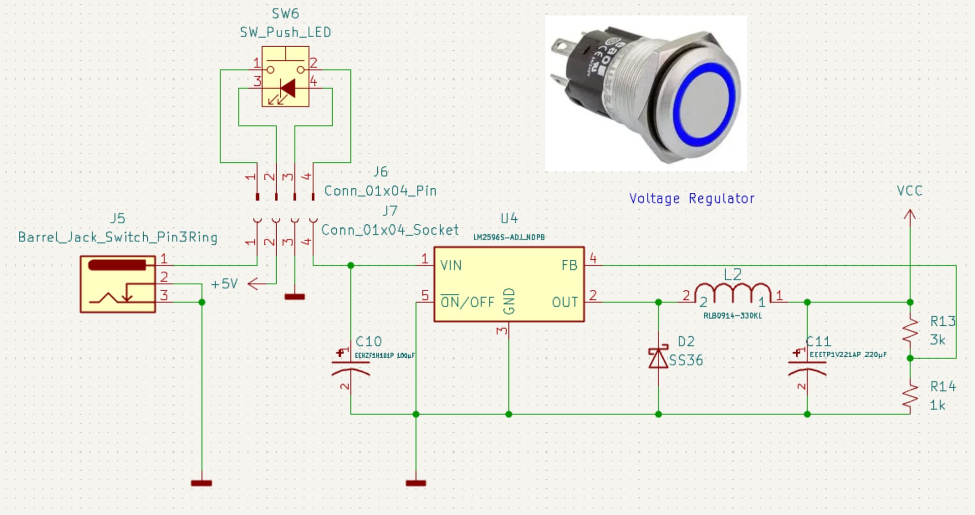

I like your second attempt with the 4 contact connector better. You can use the Exclude from Board attribute for SW6 and J6, or else they will be added to the PCB too. You probably do want these in your BOM, but not on the PCB.
Another (and a bit sneaky) method is to assign a connector footprint to your switch. This looks neater on the schematic, but in this case neither the switch nor the mating other connector will show up in the BOM, and you also have to be careful with the pinout. This method would be reasonable if you want to solder wires to the PCB directly. In that case you will still need a footprint on the PCB to solder the wires to.
Yes, the terminology is a bit confusing here, it has a pushbutton action but a switch function.
Your comment made me realize that, so I replaced SW6 with SW7, which I think makes more sense.
I agree that this method would look neater, but I’ll stick with the connector. That way, the PCB will have a more homogeneous look, since in the end I’ll have four different connectors placed on top of it.
Apart from mentioning the series resistor, your LED is also connected in reverse. Apparently I forgot to add that to my earlier post.
Yes! I noticed it and already changed it, thanks :slight_smile:

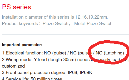

Looks nice but I need it to have a latching operation not momentary.
Apparently there are latching versions of that PS switch.
If it’s got some electronics to sense your finger, then adding in an extra flipflop inside the switch is trivial.

Yes, that is why I mentioned that they apparently exist. I did not look at any datasheet, I only saw:
I buy them from our local distributor. So to not give link to Polish language page I have just found that page and short look at text you circled told me: “No latching” :slight_smile:
