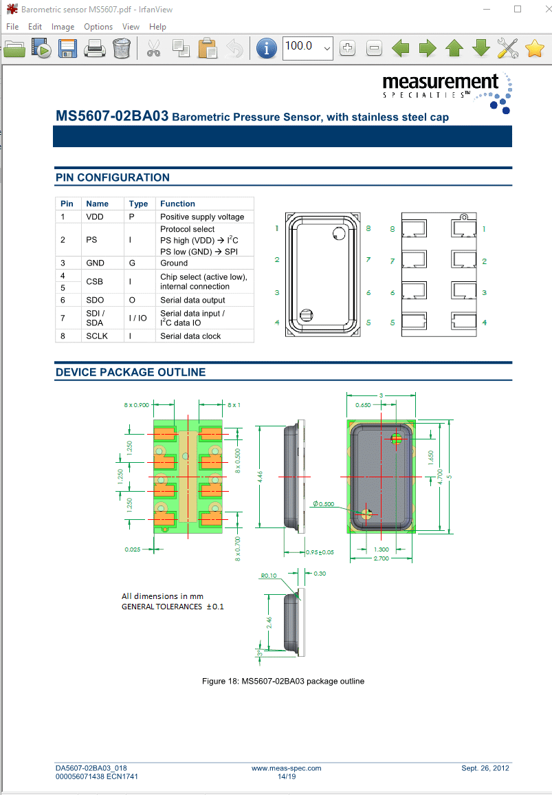

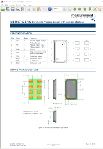

I am making a PCB using surface mount components. It will have a PIC 18LF2520 on it also a Barometer module 'MS5607-02BA03
It is 3X5mm and I’m sure I noticed QFM. It has 8xPADS
Is there a PCB footprint for it please?
cheers, Camerart

See if this works.
DIP-8_SMD
Just check the measurements.
It looks more like the LGA-8_3x5mm_Pitch1.25mm from Housings_LGA
(But make sure all measurements are correct. LGA packages are not really that standardized.)
And the DIP-8_SMD is now called SMDIP. This allows for better footprint filters.

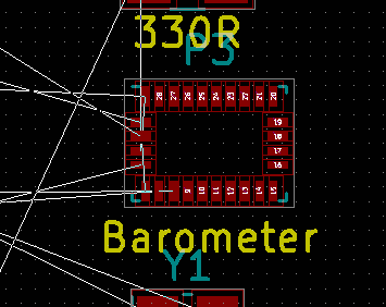

For some reason I’m getting this when I look at the PCB.
I’ve just uninstalled and installed the latest Kicad, perhaps that’s the problem.
C…
EDIT:I’ve now got an 8 pin fottprint but it’s not right, so it could be operator error. i’ll keep trying
The LGA-8_3x5mm_Pitch1.25mm is the correct one, thanks to Rene and all.
