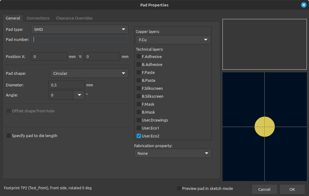

  • Create footprint with a circular pad for the backdrills just in User.Eco2 (for example) or any custom layer.

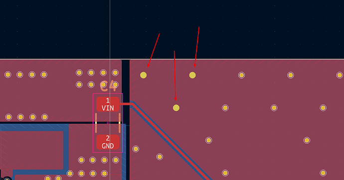

  • Add footprint on selected backdrills

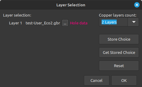

  • Open this layer using Kicad Gerber Viewer and Export to PCB Editor without Automatic Layer Assingment.

I created a circular pad in the footprint editor on the User.Eco2 layer and B.Cu layer. This pad was specified as a NPTH, mechanical pad with a pad diameter of the required back drill. I kept the padstack as normal. The attributes (refdes, value, description) were assigned to the B.fab layer.

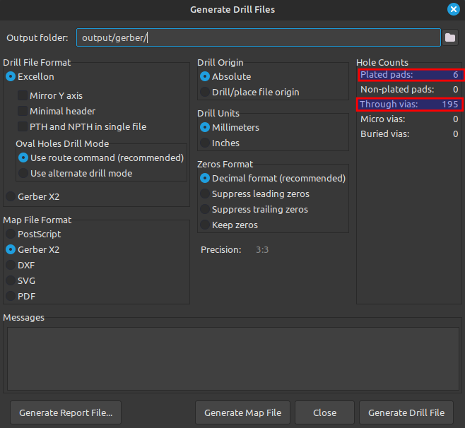

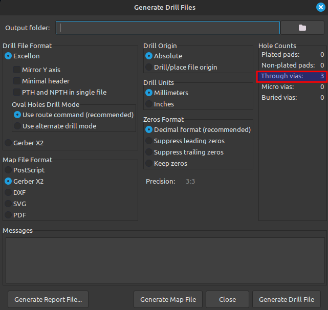

In the PCB editor I instantiated the footprint over one of the through hole vias. I then exported the User.Eco2 layer as a Gerber layer. In the Gerber viewer I exported this layer as “Hole Data”. I open this “kicad_pcb” file in the PCB Editor and generate a drill report. I now see a lot of drills and not just the one that I was expecting. I also see that the exported “kicad_pcb” shows a different orientation.

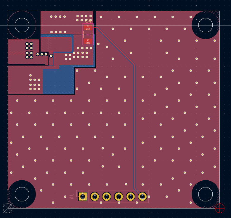

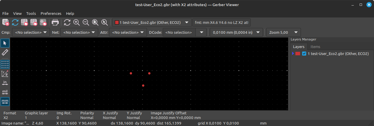

I attach a (plenty of vias) v8.0.3 Kicad project as example. Basically these are the steps you can take into account:
test.zip (74.5 KB)
Layout Example and Generate Drill Files report
0.5mm backdrill-pad footprint
3 backdrilling-pad placed over THT vias
3 Backdrilling-pad opened with Kicad Gerber Viewer and export them as Hole Data. Note that a new backdrilling.kicad_pcb Kicad PCB will be created.

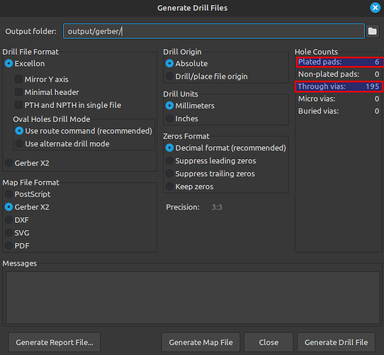

Here’s the last step:
Drill Files report of backdrilling Kicad PCB file
Thanks. Let me try this and I will let you know.
As another workaround, I followed your recommendation of using a pad footprint as a backdrill indicator. But, i specifed the pad type to be a NPTH. With this, the drill report contains PTH and NPTH at the correct locations. Now I just need the fab house to confirm if this specification is adequate and if they can control the back drill depth based off the fab sheet spec for NPTH. Holes with different depths could be specified at different user layers.
