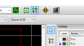

The menu which appears when you right click anywhere in the sheet with both “Mode track: autorouting” and the arrow selected (see below) gives Autoroute as the second top option. Sorry to say, but to me that’s a built-in autorouter.
But I’m not fond of the work of autorouters in the first place, this one included. Ignoring edge cuts and keepout areas is just a decisive no go.

Yes, there is a built-in autorouter.
I never use the autorouter. This said, I don’t know how old the autorouter algorithm is, but I think it has not been updated for years.
Related to your question: edge cuts were not ignored in the past, make sure you have a closed edge cut. The autorouter was written before the keepout area function was added to the code, so the latter is not a surprise.
