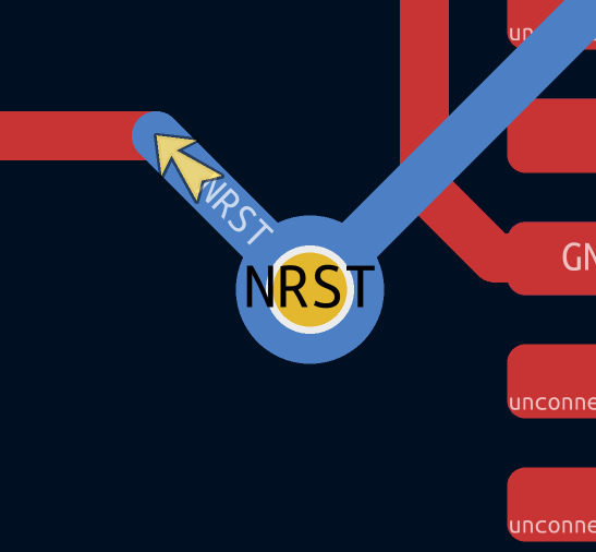

I am trying to route a very simple microcontroller board. I followed the instructions in the plugin manager for installing the recommended autorouter. (Got jre21 from adoptium.net, got freerouter 2.1.0 from github, and got the kicad plugin from the plugin manager)
However half the time there unconnected ends as shown below:
How do we get cleaner autorouter results?
This is a trivial board with plenty of space for routing. (The board is a few inches on each side and the only signals are VDD, VCORE, GND, NRST, BOOT0, SWD, and SWC. It’s literally the most trivial microcontroller board possible.)
Please no comments about how we shouldn’t use autorouters. (I have designed 100 PCBs using EAGLE’s builtin autorouter for most traces. I am not going back to 100% manual routing.)
update
After looking at individual layers, I realized that this may be just a cosmetic issue. The signals are actually connected, but there is some metal overhang. Nonetheless, it makes me wonder if this autorouter is going to be able to handle more complex boards, such as what we could do in EAGLE (before it went away).

The routing happens outside of Kicad. Have you tried asking the freerouting folks where the issue is? I’d think that the plugin has some problems with the start and end points from the sounds of it. I don’t know if the track cleanup tools from inside Kicad would help as I haven’t used them in quite awhile.
No. Definitely not. KiCad only provides an interface to exchange data with an autorouter, and has no links whomever provides the autorouter. I guess this interface can even be used with different autorouters.
But KiCad does have: PCB Editor / Tools / Cleanup Tracks and Vias, and you can use it to: Delete tracks that are unconnected at one end

Furthermore, Freerouting isn’t specifically for KiCad either. Other ECAD suites that implement the dsn-ses interface can use it. The place to report issues is Freerouting’s GitHub site.
