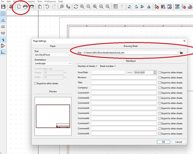

In the drawing sheet editor, you can place graphics anywhere you want.
kicad_sW7bL7VTCj
In eeschema page editor you can select your new template.
It’s *.bmp however :frowning_face:
Thank you so much @straubm worked fantastically. Not only BMP,I imported PNG.
The only one thing is that once imported, you can’t change size nor position. But it worked :slight_smile:

I can change the position big time. Changing size does not work.
DPI changes the size.
Ah, thanks. I was expecting like a resizing frame or so.
