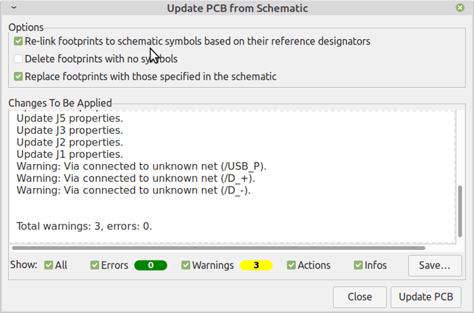

For example, if your test points just have a RefDes of “TP1” through “TP50”, then you can just annotate new schematic symbols in the schematic, and then use: Options: Re-link footprints to schematic symbols based on their reference designators
If this is good enough for you, then it is a quick fix.

Thanks for the ideas Paul! I didn’t think of Re-linking based on reference designators. I did have the signal that was connected to the test point available in one of the fields of the test point, but I think It will be easy to make a script that will repopulate the values after the test points were deleted.
In addition, the test points are on the wrong side of the board, which really only effects the silkscreen in this case, but is slightly annoying. I ended up just making a test footprint that had the silkscreen on the “bottom” of the board, which solved the problem.
Either way, the procedure you showed gets me close enough to make a first batch of boards to test, which is very useful.
