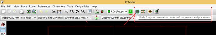

is there any way how to auto arrange components in kicad because it’s really exhausting doing that manually especially when you have hundreds of them.

i cant’t find that option in my kicad, i’m using 4.0.2 version of software. is there anything else i should do to reach to that point.
i meant the global movement
  1. click on the top icon
  2. right click and select the menu
    :smiley:
when
i right click i do not have this menu you are showing me. this is what i have got.
You need Default View mode for this, it is missing in OpenGL View
how do i fix this one?
ok, found it. thanks guys. i switched to default view mode, thanks a lot.
