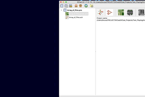

Yes… see vid below
Making an Array is easy… Setting/Changing Pad type is easy…
I did Not bother to change Pad type - I leave that to you… (hint, double-click the Pad - change it before making the Array)
array_480.mov
